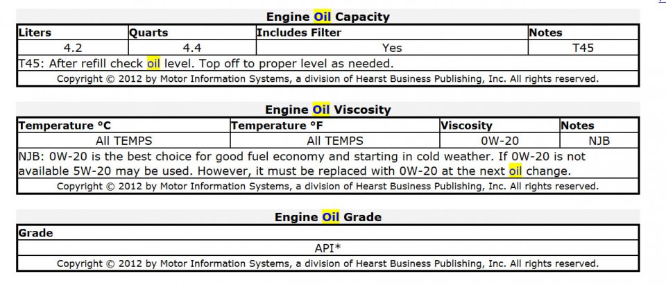

    Here's the data sheet for your car.

    Toyota dealers aren't bound by Toyota. They're independently owned. Your dealer is a JERK.
    Go to the auto parts store and buy the proper oil and filter and have an independent shop change your oil before you have possible engine damage..
