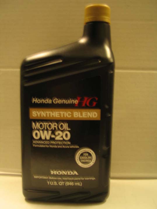

  5. Former Member 68813
    Oct 3, 2010
    3,524
    983
    US
    Really?
    [​IMG][​IMG]

    I would use the 5W30 over the others you have listed.
  7. Drdiesel
    Drdiesel Active Member
    Jun 11, 2013
    585
    153
    Monterey CA
    I was telling him to buy 100% synthetic. I see you found one of the few that has the blend. Sorry for the confusion :confused:
