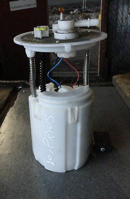

    Hi tony. The filter is in the tank, so not easy to get at. The filter comes out with the fuel pump and fuel gauge sender unit. Not sure if the tank has to be removed or if there is an inspection plate under the rear seat as in the gen3. The complete unit part number is:- 77020-47041 pictured below.
    John (Britprius)

    Tony I think the filter is a fine plastic strainer that can be cleaned rather than a sealed filter.

    This looks similar to the Gen III filter. Therefore I suspect that the large canister is in fact a charcoal filter and this is the part that needs to be replaced as in the Gen III.
    There is also a plastic strainer as John states which is just cleaned.
