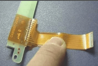

    I have finally fixed it.
    I removed the dashboard. Removed the speedometer Cluster then removed the flex of the projector. Cleaned the flex and reinstalled every thing back. The projector started working well

  9. ChapmanF
    28,737
    19,038
    By 'flex', you mean something like an FPC connection to the projector circuit board?
    or something else?
