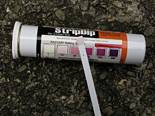

    There is no longer an industry standard mileage or time interval for flushing brake fluid. You do when your moisture content level or copper ppm rises above a threshold.
    Modern day fuel injectors don't need flushing either. All gasoline additive detergent packages have fuel system cleaners already. With the advent of pintless injectors decades ago and modern detergent packages, fuel system flushes are completely unnecessary.
    I have 314K miles on my gen II and it's never needed a fuel system flush and amazingly it's on the same original brake fluid still showing 0% moisture and 0 ppm copper. I've had other cars that needed flushing every 30 to 40K miles based on these criteria but the Prius brake fluid rarely gets heated and it's the heating cooling cycles that result in taking on moisture.

    You can do a little bit of a bleed from one of the calipers (perhaps the one stuck on the end on the longest line) and use the fluid you collect from the bleeder for the test, and just put an equal amount of fresh fluid back into the reservoir. You can proceed to flush everything if the test makes that look worthwhile.
    Mine at 145,000:
    hobbit's at 110,000:

    I have checked at the calipers from time to time using Speed Bleeder one way valve. In my experience, the moisture and copper levels are always the same at the caliper and the reservoir.
    Just google or amazon any brake fluid moisture probe and copper test strips. The moisture probes are electronic. The copper strips are use once and throw away.
