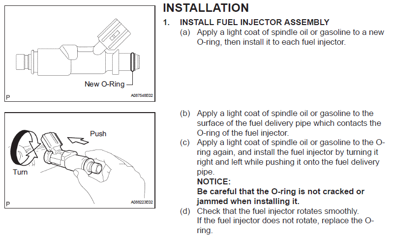

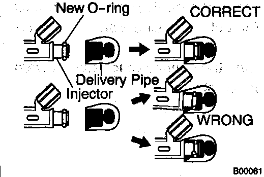

    The ends that go in the fuel rail have O rings. Put those ends very carefully into the fuel rail first, lubing and twisting as needed.
    The bottom ends that sit in the cylinder head sit in simple grommets. It's easy to get those ends in, as you install the rail with the injectors' O-ring ends already carefully inserted into it.
    If you put the injectors in the cylinder head first and then try to get the fuel rail installed over them, you take a significant chance that the O-ring ends won't go into the rail right.
    If you then try cranking down on the fuel rail bolts thinking "this'll make 'em go in", you will, if you are lucky, only destroy some O rings, and if you are less lucky, you will destroy some injectors.

    Correct... whoops.. I'll be sure to rotate only on insert into the fuel rail....and slowly push down on the injectors all ready installed into the fuel rail....down into the cylinders..

    As your last step of inserting the injectors into the fuel rail was to verify you can easily twist them back and forth, if you find a little twisting eases them into the head grommets, there's no reason not to.

    2) Put fresh clean petroleum-based axle grease on the o-ring on the fuel rail end of the injector, and put some on the dimple in the fuel rail where it goes as well. Not an excessive amount, just enough so they will always slide grease-on-grease on both surfaces. Don't cake it on--you don't want your fresh injector to get grease into its working parts, but use enough to slide grease-on-grease. When you insert your first injector into the fuel rail, you'll get a feel for how much grease is needed. (By the way, if worried about your grease, consider testing whether gasoline melts away your grease. It should.)
    3) Bend over, and watch the o-ring, and very, very gently move the injector back and forth slowly until the o-ring slips into the rail. I did not twist mine. Press gently until the injector is fully seated in the fuel rail. It is possible to actually watch the o-ring for each injector as it slips into the fuel rail, although you may think you can't for Cylinder #4.

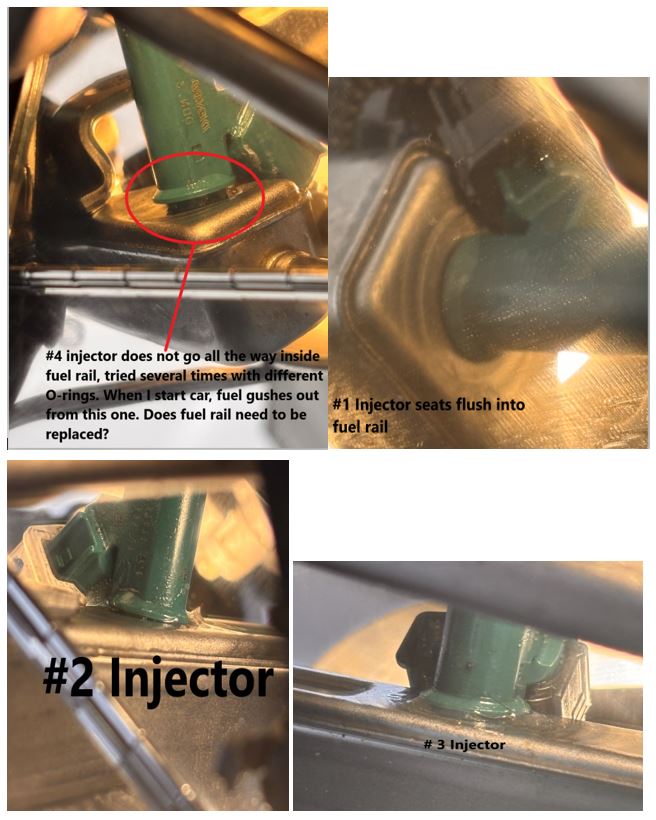

    Thanks for the detailed instructions. I re-read this several times and tried to correct my fuel injectors installation with new O-rings few times already. No matter what I do, fuel keeps gushing out of #4 injector on right driver side. I am beginning to think that fuel rail somehow got damaged and it needs to be replaced. I took pictures of how all four are seated into the fuel rail. As you can see, no matter how many times I tried, I could not get #4 Injector to seat flush into the fuel rail. Please let me know what you think I should do? Replacing fuel rail is something I wanted to avoid if at all possible. Thanks again!

    hmmm. I assume you lubed it with gas...and twisted as you pushed it in? Did you try an older O ring just to confirm it will sit flush? Then switch back to a new ring?

    It looks as if that #4 injector's O ring has not stayed in its groove, but has rolled out and down and ended up between the flange and the rail.
    If that keeps happening on multiple attempts, then I suppose there could be something weird about that bore in the fuel rail. I guess you could get a new rail, fit all four injectors into it on the bench with good light and access, then swap that rail for the old one.

    Yes, I did everything you said and much more ... frustrated and scared to see fuel gushing out of #4 no matter what I tried. I tried #4 with multiple O-rings, few new and even original ones. As far as I can, the O-ring slides inside just fine with some lube and I did twist left and right very gently while inserting it. It just does not seat flush to the fuel rail no matter what ...

    Hi @ChapmanF : Thanks for your suggestions. Please read my post # 15. I do not think O ring rolled out. That black portion you can see in the picture is not O ring, it's part of the injector. The O ring color is orange and it slid inside just fine with some lube with the method you described in another post. Thanks again!

    Thanks again! I will try one more time with another brand new o rings that I am waiting. If that does not work, I will decide to replace the fuel rail or something else ...
