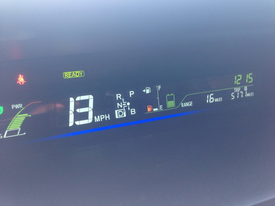

    Has anyone noticed any inaccuracy between the fuel gauge and the range (miles left) readings?
    In the past the low fuel light would come on when there were no bars of fuel left on the fuel gauge. Now it comes on when there is 1 bar.
    Several times now, the low fuel light comes on when I've still got 1 bar on the fuel gauge and the range says 16 miles. For these tanks I'm averaging over 54mpg so if I've got more than 1 gallon left, 16 miles can't be the range. (Before someone says it errors to the cautious side and there is a reserve read below). (The tank holds 11.9 gallons so take away 1 gallon for reserve and divide by 10 bars on the meter so each bar represents approx 10.9/10= 1.09 gallons)
    Which should I trust, the gas gauge which is possibly showing too much gas or the "range" which is possibly grossly underestimating the mileage left?

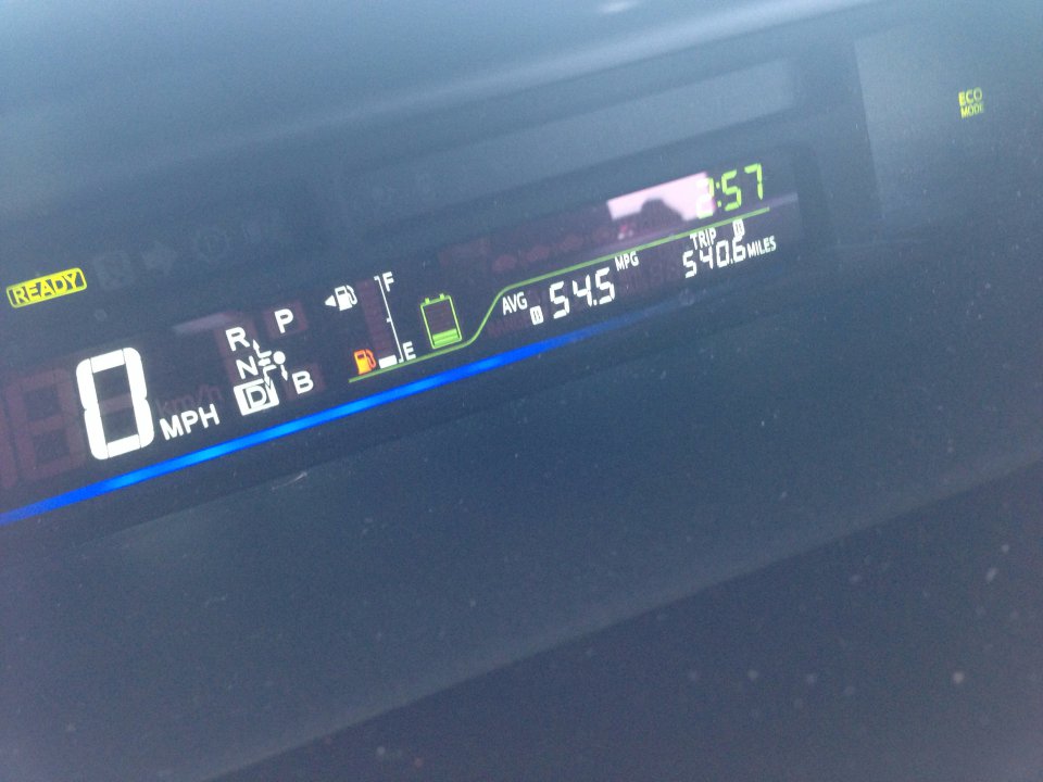

  7. wstt
    wstt Member
    Jul 11, 2013
    148
    26
    Just to give an update. I forgot to post this after. So the light came on with one bar of gas left in the tank which is strange because it normally comes on with zero bars of gas left. I was also getting great mileage that rank 54+ mpg which would make me think the low fuel light would come on later, than earlier.
    So it came on with 16 miles of range and after 517 miles for the tank. Well, I drove another 23.5 miles, or well into zero range and my fuel meter still showed one bar. So either my fuel meter was stuck at 1 bar, or the range thing was way off. I'm guessing that 1 fuel bar was there for way too many miles. Oh, and the car took 10.3 gallons at the pump. image.jpg image.jpg
