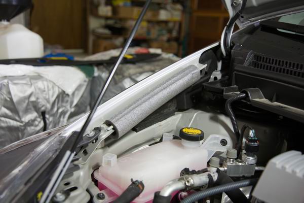

    ^Sealing the gaps between the hood and fender can help hold in the engine bay heat. I use foam pipe insulation pieces for this, pushed onto a convenient crimped flange along the seam.
