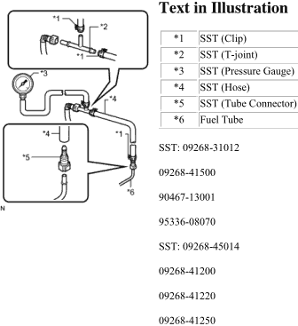

    Also, i have now replaced all spark plugs, all coils, all fuel injectors, and the MAF sensor. Still misfires same way. I think its because the fuel line itself cannot hold pressure. I am getting a code saying vapors are escaping and improper fuel to air ratio, in addition to the usual cylinder 1 misfire and occasionally the other cylinders as well.
    Is there anyway for me to test the fuel line for its ability to hold pressure? Is there a guage i can get or fitting to try pumping air into the line and see if it holds?
    Or better yet, i can try and re-connect the areas of connections. The paint thinner i used might of destroyed the O rings and hence why pressure might not be holding. Thats my hypothesis at this point, since i know it cant be the fuel assembly or fuel injectors due to replacing it.
