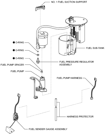

    The level sender and the pump are both parts of the same assembly you pull out of the tank, but can be replaced separately, so the shop might not have replaced the whole enchilada.
