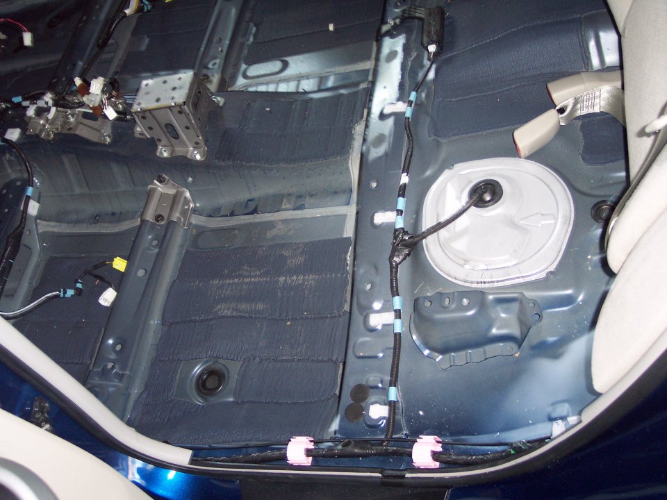

    do you have to drop the tank to do that? iirc someone else had this problem.

  12. bisco
    115,389
    52,820
    that's easy access, thanks.
