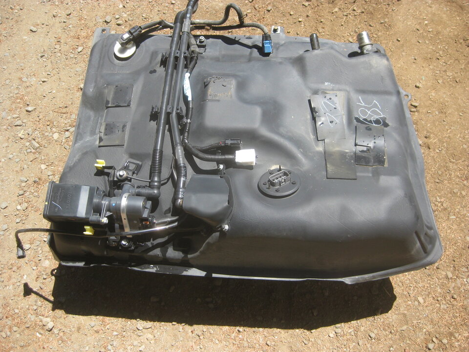

    Tank is out...and I had to drop the exhaust. Now it looks like the Vapor separator 77730-47030 is a more likely culprit for codes rather than the charcoal canister. Using a smoke generator into the tank, smoke comes out the intake pipe of the unit. I believe the valve is stuck open. Anyone ever pull one of these units and test it? gas tank top.JPG

    What codes do you have and what testing have you performed?
    That part # is for the "trap canister with outlet valve" - the valve is actually the leak detection pump assembly. The inlet "fitting" is the vent for the fuel tank - evap system and is normally supposed to be open.
    The pump "seals" the inlet when the ECM commands the vent solenoid shut and turns on the pump to check for leaks.
    The system leak test has two thresholds - a 0.040" leak and a 0.020" leak. My experience is that most smoke machines are marginally effective below around 0.025" leaks (ie, I can't see the smoke, but it leaks enough to set a P0456 small leak code). I often have to spray soapy water on components with the smoke machine pressurizing the system.

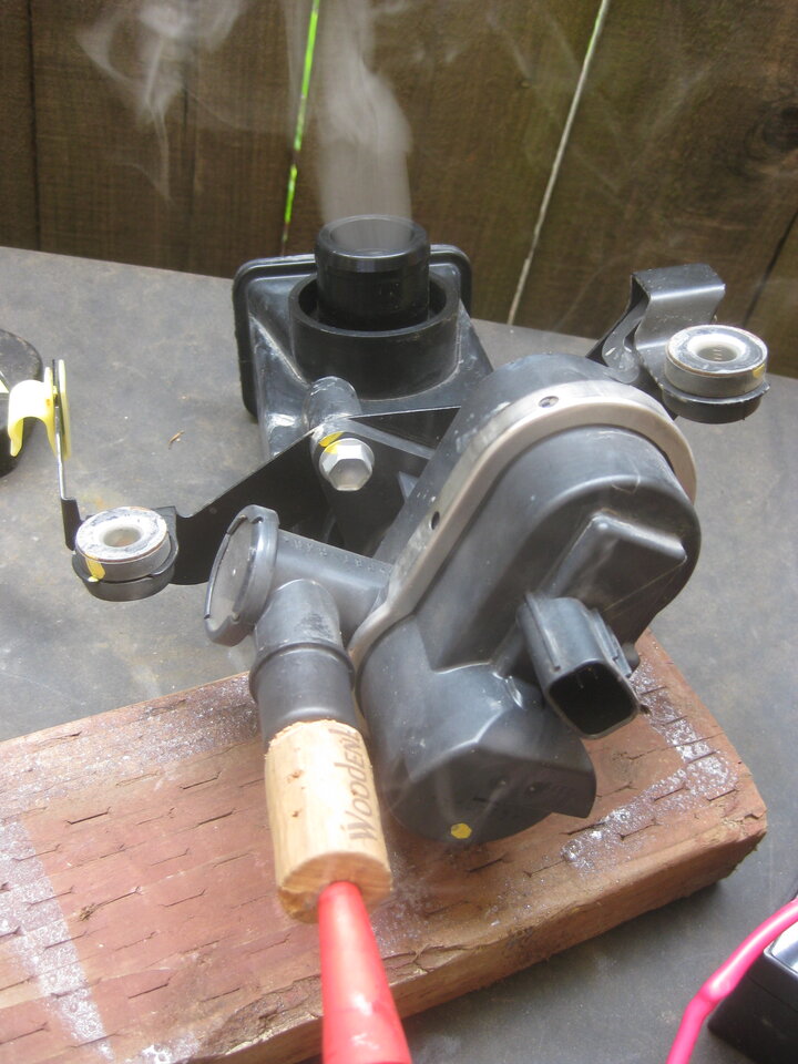

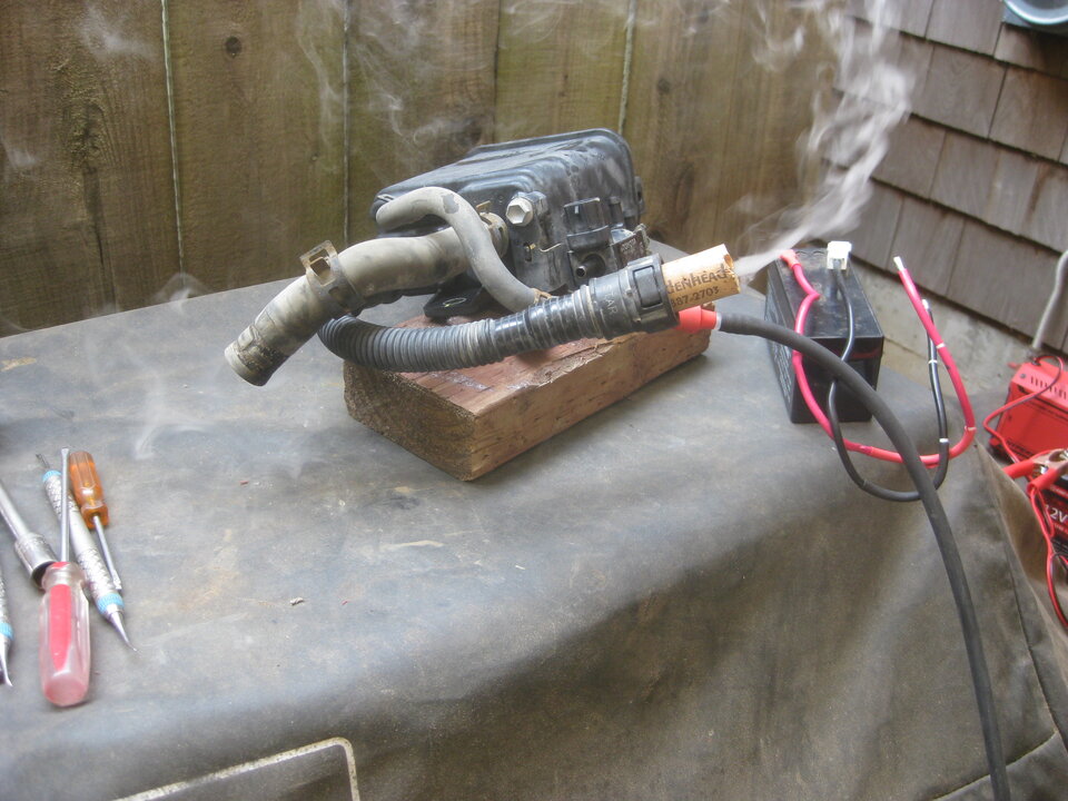

    Here are smoke tests of the charcoal canister and the vapor separator. I don't know if these prove anything definitive but I'm most concerned with the vapor pump. Should smoke be going thru with no power connection? I did connect power, briefly, to the unit and it did sound like it was running the small pump. Vapor separator & smoke.JPG Charcoal canister & smoke.JPG

    The previous owner ran the car for over two years with EVAP codes. 441,446,455, I believe.
    I smoke tested the fuel filler cap and it held smoke. I replaced the separator valve at the canister with no change.
    At this point I have a new charcoal canister but don't want to re-install the tank if that testing pump is bad.

    OK, so it's a fact that the pump is "open" normally and waits for a signal to close....and what closes it to flow, is internal to the pump? So, I need to figure out which pins to activate to close it...or trust that it will work...and put the tank back in...

    IDK what tooling you have.
    When I see a car like this I first visually inspect the gas cap, then use a capable scantool to actuate all the solenoid valves via bidirectional commands. I want to see that the ECM "can" operate everything, and whether things move (make klunk sounds).
    Next perform the scantool evap system test and note the results. The Leak Detection Pump has a pump, solenoid valve, and a pressure sensor.
    When the solenoid is unpowered & "open", it vents the system, but at the same time it connects the pump and pressure sensor to a 0.020" orifice.
    The ECM turns on the pump and "calibrates" the test by seeing how much vacuum is possible with a known 0.020" leak. It then powers the solenoid on, which connects the evap system to the pump and pressure sensor.
    Now the pump is trying to apply vacuum to the entire tank and evap system. If there is no leak or it's smaller than 0.020", eventually the pump will achieve a "higher negative pressure" (more vacuum) than the calibration test value. The test passes.
    If it has a larger leak, it will never reach the calibration value and the test fails. The ECM looks at how badly it fails to decide if it's a small (P0456), medium (P0442), or gross (P0455) leak.
    Here's where I smoke the system, while everything is still together in the car. Sometimes I do have to drop the tank. Then I have to cap every line and smoke - soap test things.

    I started with a new gas cap and a used cap off of another Prius. Neither helped. I bought a smoke machine and tested the 3 caps in situ. The new cap was the worst! I couldn't get it to seal on my '07 or '04. One used cap would seal on the '07 and one on the '04 but I couldn't interchange them and have them seal...
    I pinched off the hose to the charcoal canister, btw. I also tried soapy water spray on everything I could see. This was after I pressure washed the entire area including the fuel filler piping. I had no bubbles or smoke come out of anything. I swapped out VSV valves between cars. No change. Only after all that did I drop the tank and bought a new charcoal canister, on the advice of a Toyota tech person who said that '07 cars had particularly frequent problems with bad canisters. When I pulled the tank, I pulled the vapor separator pump to examine it. I was looking for bits of charcoal, hoping that I'd find evidence of a bad canister. So far, I've found no bits in anything. I held a blank sheet of white paper in front of valves, pumps and lines as a blew air thru them. I assume that even though the pump spins and is open when no
    power is applied, it may not be closing when told to by the ECM. I am going to pull the fuel filler assembly and examine its various pieces for flaws. I've been told that often, the only way to get a gas cap to seal is to buy a new filler pipe as they get distorted by frequent over tightening and sloppy fuel filling techniques. I'd like to re-install the gas and expect different results...but I doubt it will happen...
