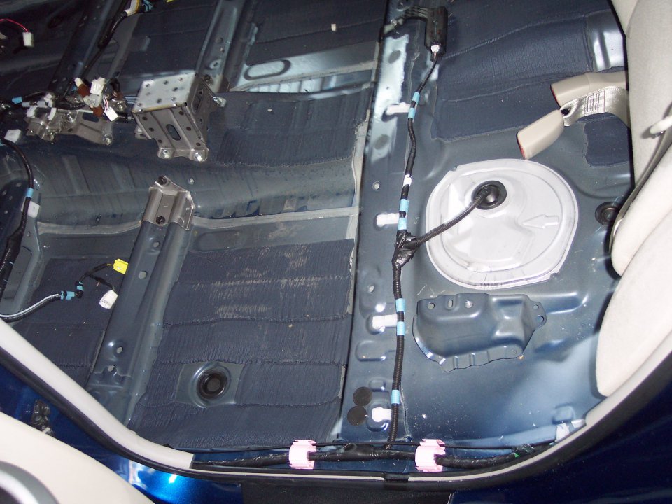

    If you are smelling gas in the car, it might be coming from this cover plate's seal being compromised. Is the odor stronger in the back seat area as the cover is under the left rear seat:
  13. simone bercu
    simone bercu New Member
    Jul 22, 2014
    Bethesda,md
    No way. It was purchased new at the same dealer.
