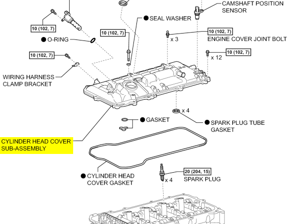

    Directly underneath the (plastic) No. 2 cylinder head cover is the (Aluminum, No. 1) cylinder head cover assembly.
    From a Smashing Magazine article:
    The plastic vanity cover would be listed in a catalog as Cover, Cylinder Head, No. 2, and elsewhere, unfurled right-to-left (like translating Yoda-speak), it would be the No. 2 Cylinder Head Cover. The parts catalog version is clearer as it unambiguously tells you it is the cover, [for the] cylinder head, [and is] the second of its kind. Using this notation would help sort parts by function when arranged alphabetically. In a printed list, all gaskets would appear together, as would all nuts, clips, manifolds, coolers, and covers.
    The unfurled version could say a few different things depending upon where you imagine the commas originally were (Head Cover, No. 2 Cylinder; Cover, No. 2 Cylinder Head; Cover, Head, No. 2 Cylinder; etc.), but not all of these will make sense.
