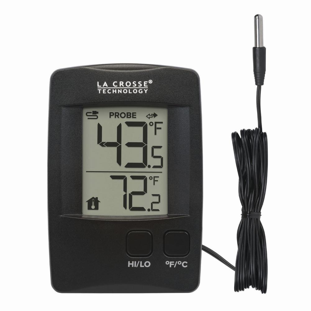

    I'm going to pick up a wired thermometer like the one below and try to put it as close to a module as possible and see if the temps are being accurately reflected by the computer.

    I put the probe into one of the module holes and put the covers back on.
    So it appears it's not an issue with the reading of the on-board sensors, as the probe and the readout from the computer are spot on.
    I have another blower arriving tomorrow. Will post results and an update.
