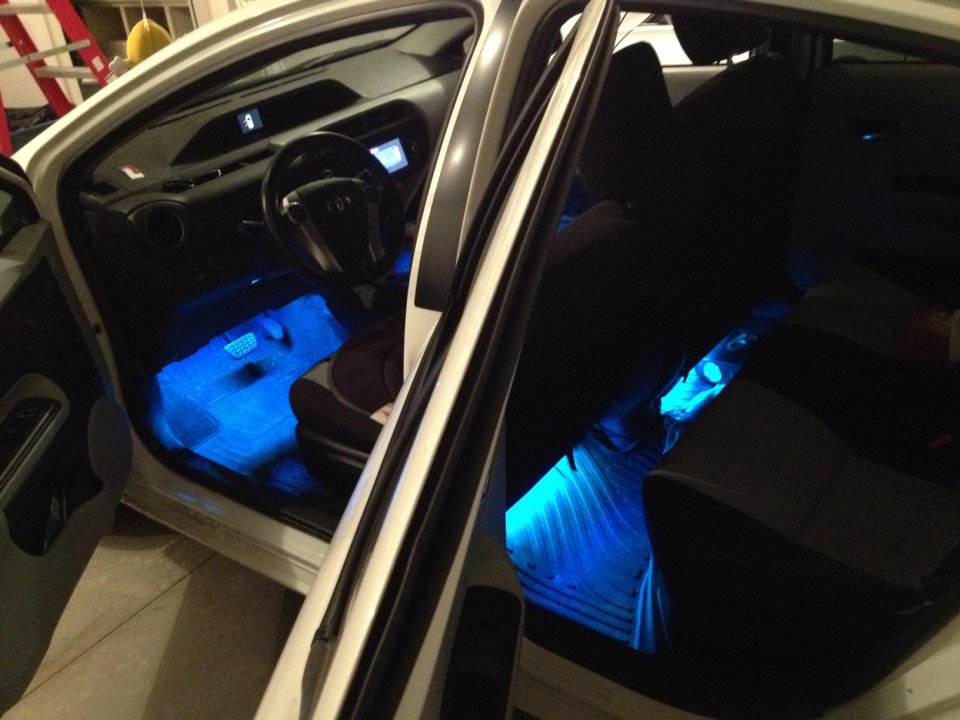

    so i installed it successfully but if someone can tell me which fuse to tap that will switch off when the car's off, that'd be great. :) at least it works! :)
    here's a pic!

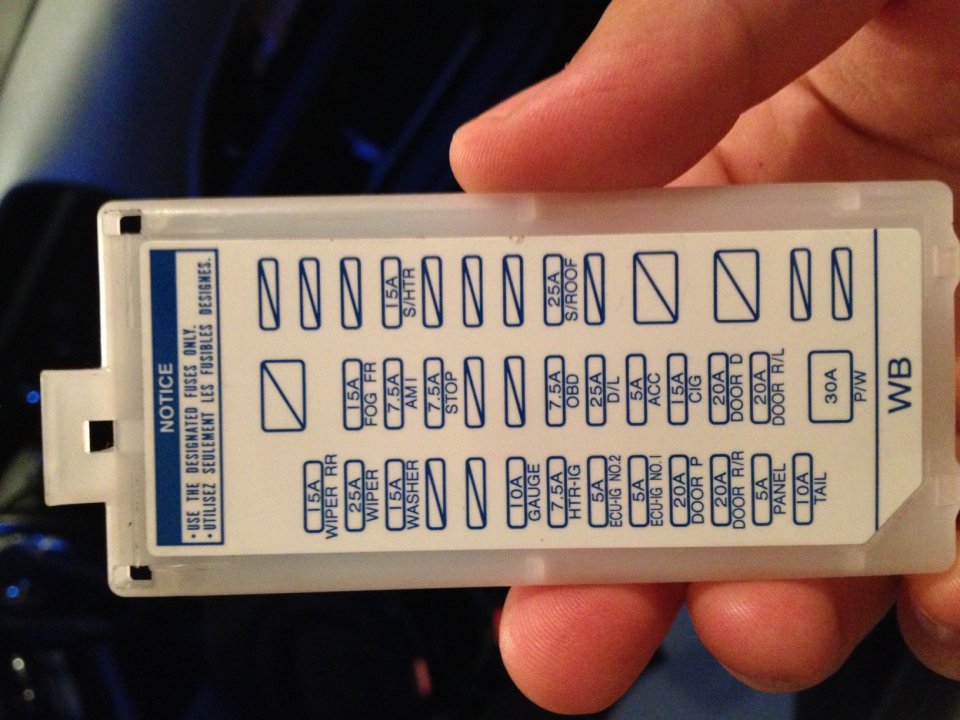

    Take a pic of the fuse box cover and post it, so we can see what's in each position. I think the fuse for the lights is always hot. You need something that's only on in accessory or ignition on.

    here's the pic of the fuse cover. appreciate your help! :)
    my preference is to have the led kit turn on when i turn on my headlights - idon't know if that' possible when tapping fuses with my add a circuit thing... if that's not possible, then i just want to tap a fuse that's on a non-critical fuse that is on a switch - so only on when the car is on.
    how does this wiring stuff work anyways? the led kit has a 4A fuse on the add a circuit for the fuse + the fuse that your replacing. does that 'overload' the circuit or something?
