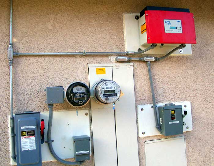

    Typically, they pull 240v off the main service panel, into a completely separate meter. But YOU have to provide the utility with the socket for them to stick it in. The 2nd meter gets its own special fee schedule ... provided you're charging after hours. Drill down into 'evnut.com's web pages and you'll find a picture of how it looks.
    Baahh never mind ... I'll find it ...
    EDIT:
    ok here ... this is what it'll typically look like once it's all set to go (minus the PV conduit, inverter, and PV disconnect):
    See - the really dirty rotten trick that some utilities do, is they'll charge you a 'fee' to have the 2nd meter. So by the time you pay an electrician to install the 2nd meter socket, and by the time you're paying a 'nominal' lease fee for the privileged of saving juice fees on the 'EV only' meter, the savings don't really ad up. Read your fine print ... I'm just sayin' ...
