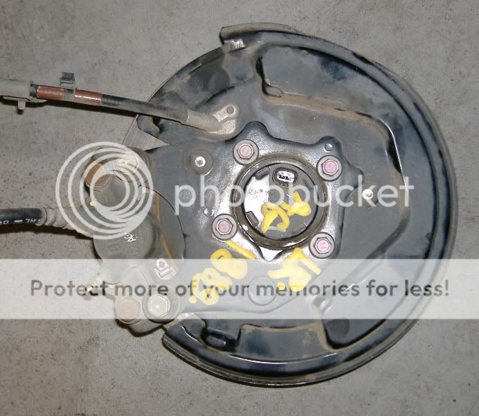

    Diagram of the Backing plate and parking brake assy:
    There is only one part number for the rear calipers.

    I will see if I can find the rear caliper part number. As I said in my previous post the gen2 pads are not held in by pins.
    I changed mine a few months back and many suppliers were trying to sell me pads like the ones you show, but checking with Toyota I found the number was different, and was then able to get the correct aftermarket pads.
    The discs are the same as the Celica. I would think the bearing hubs would not need to be changed.

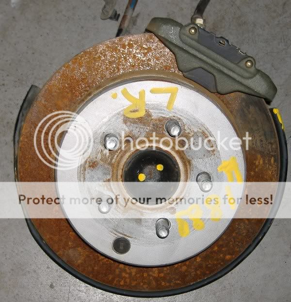

    So it looks that way...on many of the Toyota setups with rear discs...This was on a Matrix
  11. Britprius
    Britprius Senior Member
    Jun 14, 2010
    5,194
    1,922
    Herefordshire England
    Imagine how rusty they get on the Prius with regen braking down to 7mph they just do not get used.
