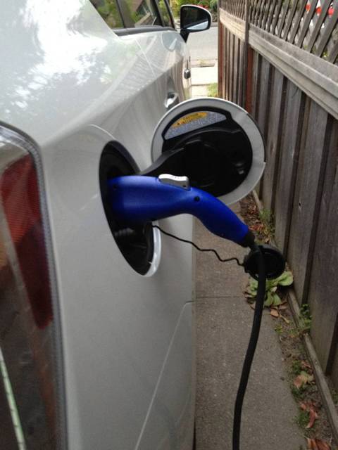

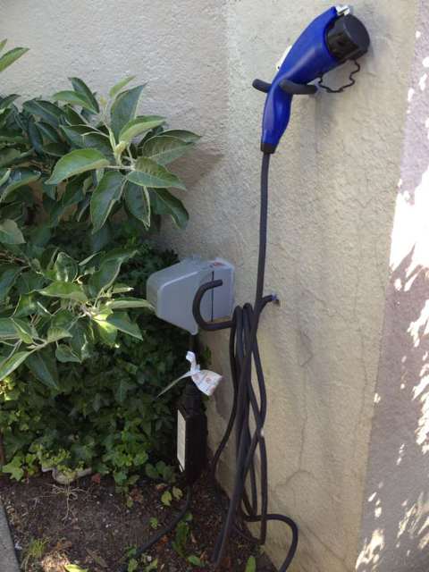

    Here in Northern California, I keep my car in the driveway. With the PiP, I've become good at backing into the driveway to charge.
    I installed a dedicated, weatherproof outlet myself, as you can see below. I installed some simple hooks into the stucco, which look fine. It's been very easy to use, taking only about 15 seconds to plug in when I get home at night.

    If you only need to charge at night (for your morning commute) and in the afternoon (for your commute home), then I'd say 120V is fine.
    But getting 1 hour's worth of juice after you get home is a pretty big difference between 120V and 240V.. its like 4 miles of range versus 8 miles. I can make it to the friends house/store/shopping center and back with 8 miles, but not with 4 miles. Additionally, since I kind of live on a hill, that trip home uphill from the store on gas is painful.. that's probably the main reason why my HV MPG is the worst out of everyone on the spreadsheet.
