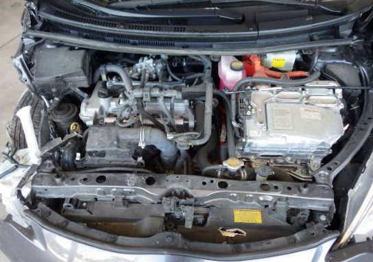

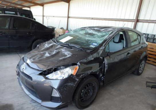

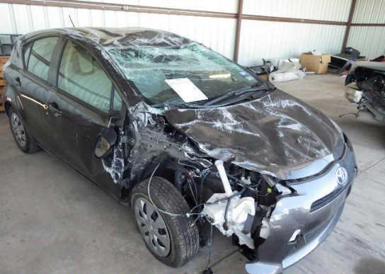

    These are pictures of Donor Car !!!

    Hi EveryOne! I got some good news!!!
    Today I finally got a guy from Toyota Dealer come over with his Toyota Scan Tool. So, he connected his Laptop, and guess what??? NO COMMUNICATION! So he tried to play with the car, start it and so on.
    When He tried to start the gas engine, I was staying with the Hood open and I heard some noise from Spark Plug Coils! All coils are crackling. So, i track down the wires and these wires brought me to the Engine Module on the Firewall behind the engine. So I unplugged the plug from the module and noise disappeared. At this point I realized that this module could be bad, because it was uncovered when I got this car, and some rain water could damage it. So, I got another module from my donor car, put it on, and Gas Engine Started!!!!!!!! WOW :)
    I was happy for about a second or two, but then, the engine was running very loud and metal to metal noise made me worry. I Lot of white smoke! However, after few min, engine was running normal. It was probably because the engine didnt run for a while, so it needed some time for engine oil to smooth it out.
    it Was I good Day Today ;)
