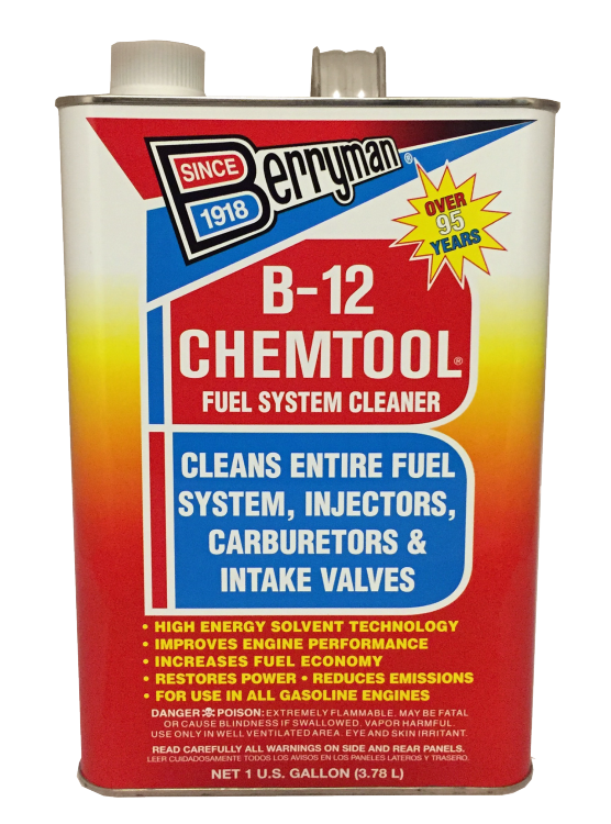

    I know someone who had limited success with freeing up a sticky gas gauge on a Hyundai by switching to top-tier gas (Chevron).
    You might also try a gas additive that contains Polyetheramine (PEA) or a similar detergent, which is believed to be the same compound in some of the top-tier gas formulations.
    Here are some options (product packaging or names may have changed) :
    Any of the Techron products that comes with Concentrate Plus.
    or Gumout with PEA (black hex in the lower right corner of the label)
    Or a BG fuel system cleaner (which also has PEA) :
    Though Berrymans does have other "gas additives" in their product line up that contain similar detergents like PEA, I would personally try Berrymans b12 - Chemtool (doesn't have PEA or similar, but is a quality product and a decent price point in the gallon size).
    Please report back, letting us know what worked (if anything) and what didn't (y)

    You can try a fuel system cleaner, as pictured above.
    But if the sending unit is bad? Then none of them will fix the problem.
    But they are a relatively cheap gamble...might be worth rolling the dice once or twice.
