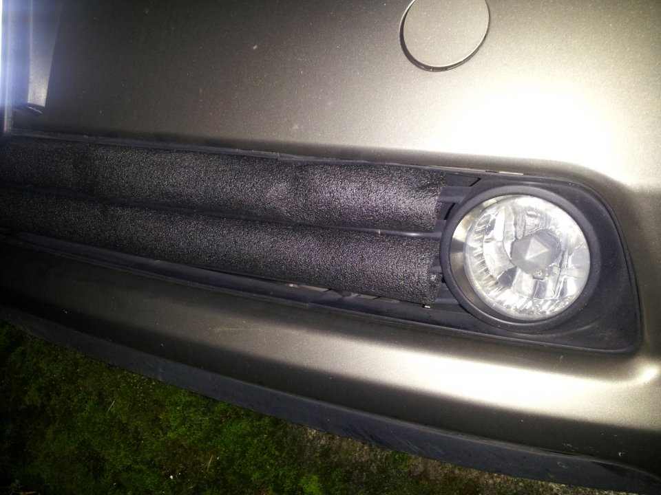

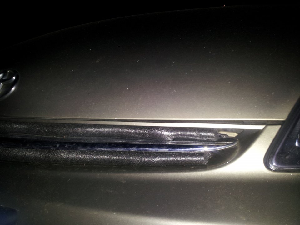

    I'm attaching some photos showing how I did mine. Sorry for the horrid quality, I just snapped these now at a quarter to 1am and my parking spot isn't well lit so I had to rely on my phone's flash.
    The foam insulation comes in 6 foot strips, I used one strip for the top grill and one for the bottom. For the top I just shoved half of a strip into each of the slots (actually slightly less than half a strip, I had a couple of inches left over from the strip I used for the top.) The bottom grill is made of flimsier plastic and after spending a few minutes trying to wedge an entire piece into the topmost slot I started feeling scared I'd break the grill, so I unfolded the foam pieces at their seam and used a 3 foot piece for every two slots of the grill.
    It didn't really require craftiness.

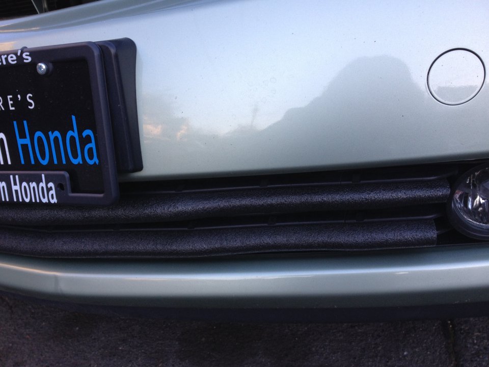

    ta da!!

    they're starting to ooze out a bit, but I didn't want to break the grills by shoving too hard.
