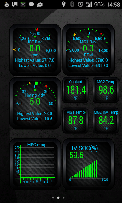

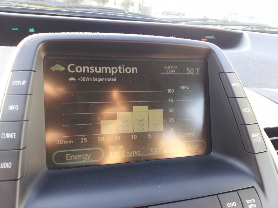

    Here's a photo of my Consumption screen and a screenshot of my Torque screen at the end of a ~20 minute drive I took earlier today, when temperatures briefly hit 50F. You can see my coolant temp made it all the way up to 181.4F and while the first 5 minutes of my drive averaged around 30mpg, after that I made it into the 50-60mpg gauge and stayed there. When it's colder out, it takes 2-3 bars to get to that point.
