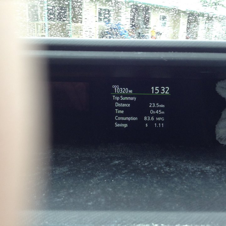

    itz been about a month now @msp4 since your original post. i have noticed that when i drive my son to school in the morning the first half mile or so i get only 16 mpg or less. yes less. itz the car warming up in the morning etc. ,,, keep in mind that not every trip to the corner market is going to be 50mpg. please drive and enjoy. and when your buddies ask just pretend evvery trip is 83mpg like mine.
