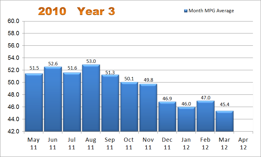

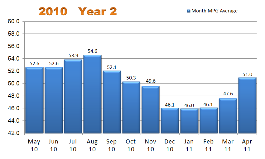

    It will be interesting as we experience winter. The discovery process of a new Prius is always very exciting. Clever aspects of the design often don't get reveal until driving in extremes.
    And I have 3 years of data to compare directly to, so we'll be off to a good start regardless of how this particular cold season plays out...
