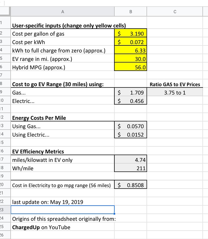

    Electric for us. Our town has two choices for community power. Traditional sources at 7 cents per kW, or renewable for a fraction more. We chose the renewable. As of today, this is what the difference is vs. gas. There are usage taxes above the kW charges of course. Prices are always a moving target.
    noonm and Raytheeagle like this.

    I was just wondering about the gas vs. elect comparison.
    Yesterday at work I found a charger (ChargePoint).
    It's 6.6 kWH station so should take about 2.5 hrs for the full charge?
    They charge $1/hr. So that would be $2.50 for 30 mile range.
    Vs. $2.50 gas gives me 56 mile range...
    I think in this case gas is cheap because ChargePoint is charging too much...
    What do you think? Or did I miss some calculation?

    You are absolutely correct. For most public charger for fee, the cost of electricity is way higher than home electricity, making it totally uneconomical solution. In the case you encountered, the charge rate is $2.50 for ~6kWh or $0.42/kWh of electricity. In my case, even the home charge cost more than gas. Electricity at $0.195/kWh compared to cheap gas at $2.50/gal.

    Yeah, most Lvl2 public chargers are not priced well for Prime charging. For reference, that $2.50 for 6.6kWh is the equivalent of a $0.38/kWh electric rate, making it much more expensive than gas in the US. I would stick to home charging or charging at 120V outlets as much as possible if you still want to maximize electric driving.

    You have it correct. For the small battery capacity and relatively low charge rate of the Prime, Chargepoint stations rarely have power that is inexpensive. Their billing is more geared to BEV's with higher current draw. $2.50 for 6.6 KWh is about 38 cents/KWh, or about 4 times what I pay and more than most pay (exceptions perhaps CA on the highest tier and Hawaii).

    Where the Prime loses is when the public charging station bills by time. Most BEVs have 6.6KW chargers, which is twice what the Prime has (3.3KW), so the cost per kwh is twice as high for Prime owners when billed by time. In some states, billing by kwh requires the owner of the charging station to become an electric utility company, which effectively kills that option, leaving only the billing by time.
    BTW, the owners of public Chargepoint stations determine the billing, not Chargepoint. So any concerns about the pricing needs to be directed to the company or government entity that owns the charging stations. Other charging station groups, such as Blink, have other billing policies.

    Its an unsustainable option for non-high charging rate vehicles like PHEVs. Also, its not like this isn't a solvable problem. Either bill by kWh used (preferable) or adjust the price/time by the type of vehicle. I want to see more charging stations, but it needs to be done in a way to keep electric driving cheaper than gas if we really want to see it take off.

    Everyone does realize that the prime battery is 6.6 kWh that is available to fill?
    So even if the fee is 2x a normal local rate (let’s use my PG&E rate of $0.25/ kWh) and the battery is completely empty, we are talking about $3;).
