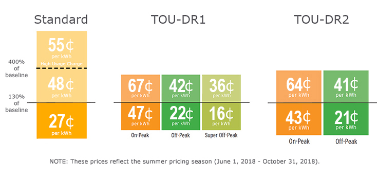

    With a Time of use Plan SDGE charges
    Actually the super off peak rate on the Tome of Use Plan is 16 cents per Kwh. (that is midnight to 6 AM)
    This works for meet, just set the charging schedule.

  12. Matt1984
    Matt1984 Member
    Nov 10, 2019
    36
    32
    San Diego
    2020 Prius Prime
    This works for meet, just set the charging schedule.[/QUOTE]
    Time of Use, TOU, Pricing Plans, TOU Pricing Plans | San Diego Gas &amp; Electric
    I don’t see a 16 cent tier.

  14. Tickwood

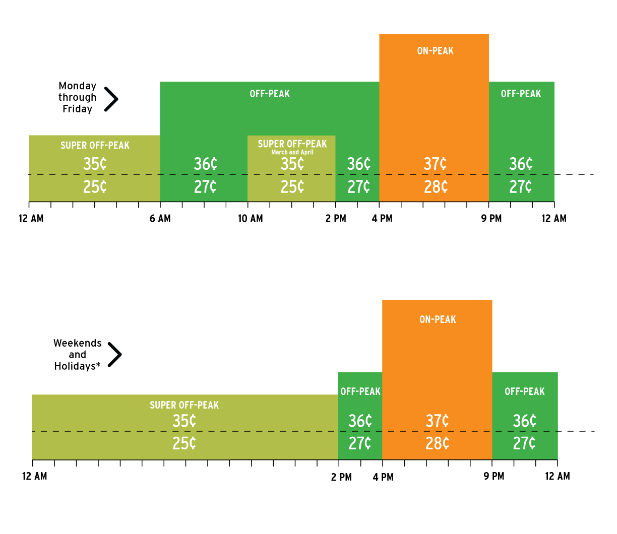

  15. Matt1984
    Matt1984 Member
    Nov 10, 2019
    36
    32
    San Diego
    2020 Prius Prime
    Can you link the URL where the 16 cent chart is coming from? I only see the charts you posted above (the horizontal ones) showing 25 cents.

  17. Tickwood
    Tickwood Active Member
    Jul 27, 2004
    334
    101
    San Diego
    2020 Prius Prime
    I wish I knew where I found them too. I cannot find them again. You are right, everything I see now is 24 or 25 cents at the lowest.
