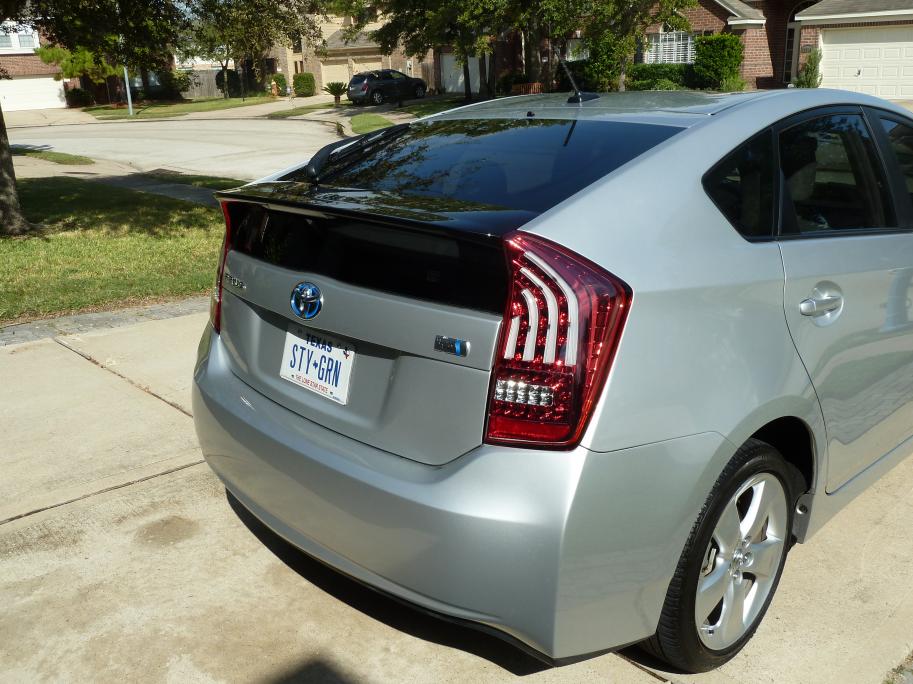

    Nice girls! Oops, back to topic. Yeah, way too much reflection there. We need better pics (of the taillights, not girls).

    I see it. Its between the reverse light and the turn signal near the middle. Looks like scratches as he stated.

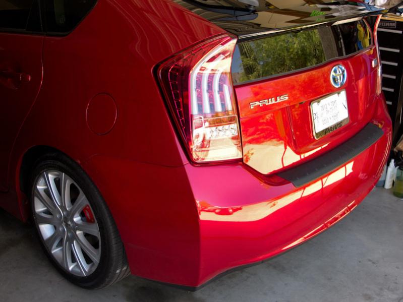

    Clear Lens/Red Chrome. It's darker red than HC. Looks especially good on Silver and Barcelona Red.
