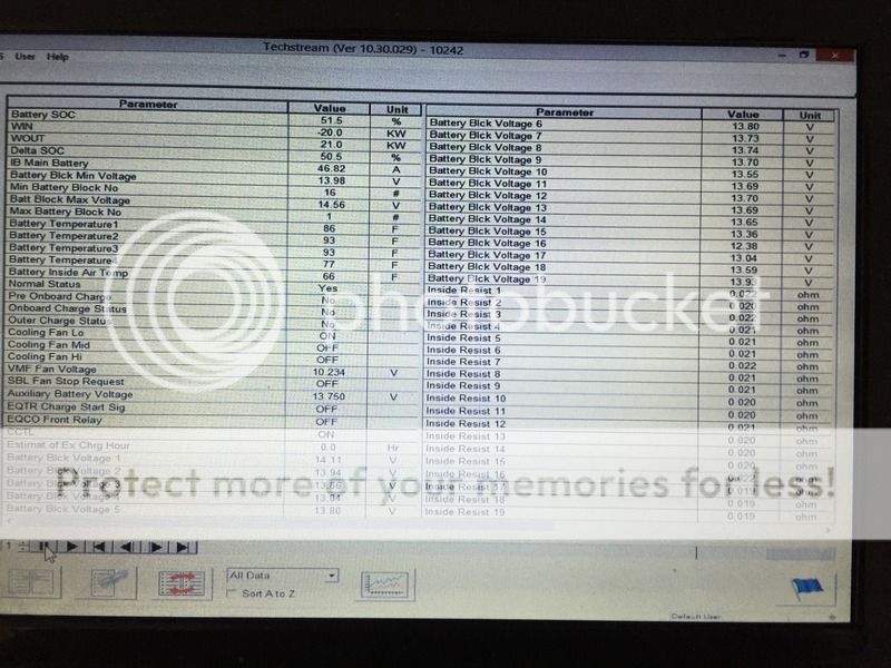

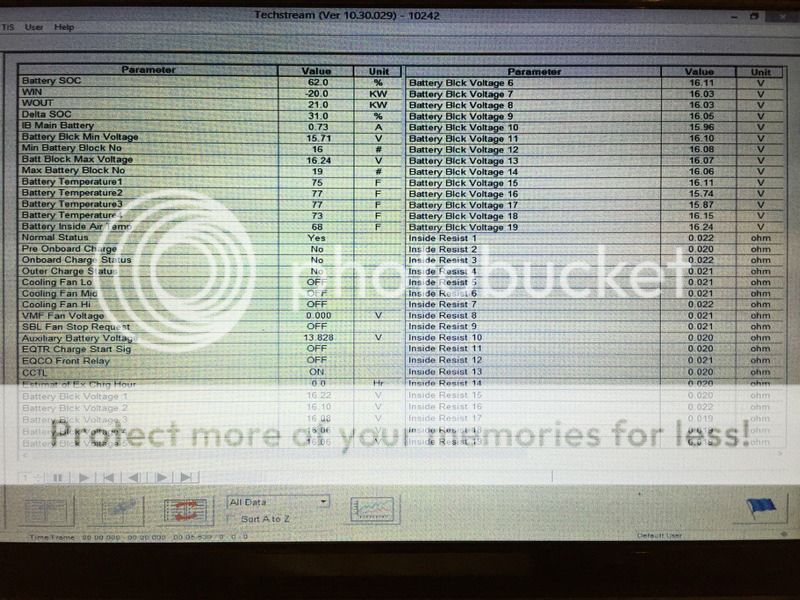

    REVERSE UPHILL WITH BRAKES ON Test Results
    Here are my readings right before ICE kicked in:
    I am not liking the OHMs on 1,3,7,16
    Any recommendations for G1 modules? I have lead on ebay for $35.00 each.

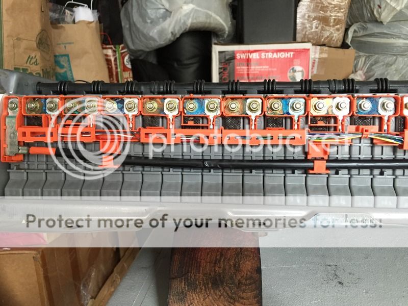

    Well Well Well:
    Look at what I found:

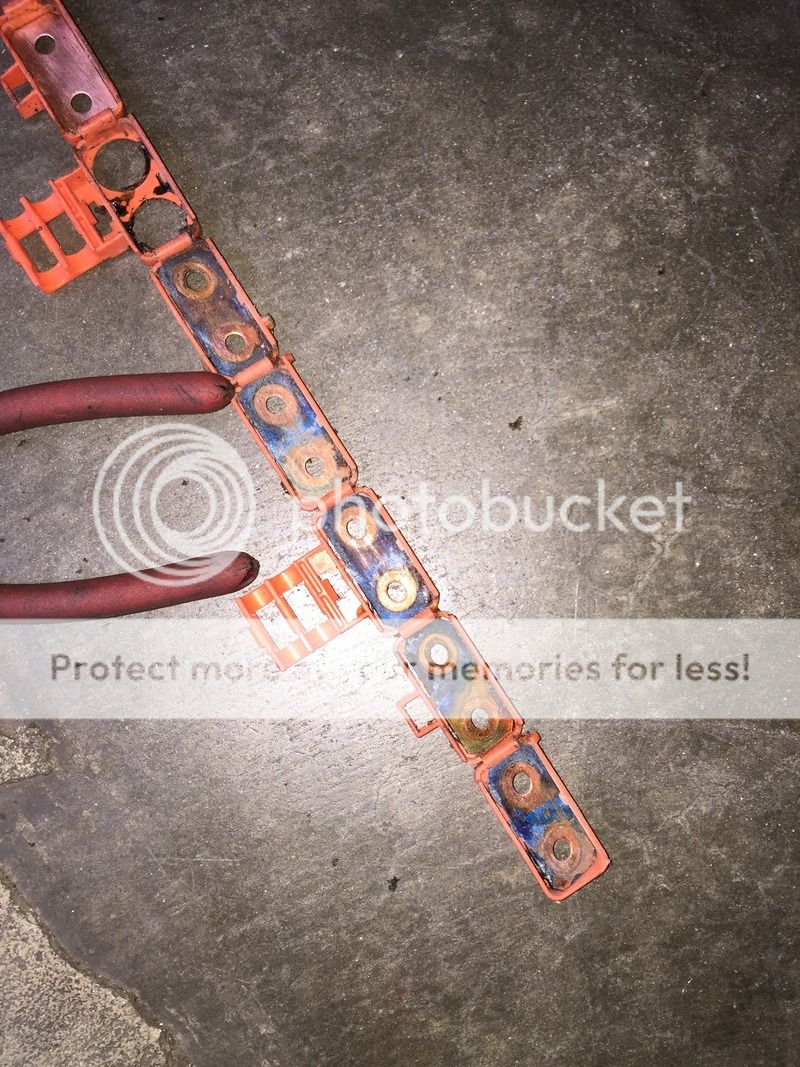

    Dr Wong, you were right on track. There is no way these cells will charge or output properly with all this corrosion.
    I will still voltage test each cell but will definitely clean using my DeOxit D5 contact cleaner. I use this stuff on all my electronics, works miracles with thought to be dead contacts :)
    If not good enough, I will order new buses.
    Jim

    The biggest risk are the sense wires. The leaked KOH can 'eat' the copper under the insulation. This leads to a broken sense wire and bad voltage reading in the future.
    GOOD LUCK!

    Bob has it. Pull ALL the bus bars before you attempt cleaning, or you'll complete some circuits you didn't want to. That looks about as bad as mine did. If you have any battery acid, soak the bus bars for a while. It won't touch the copper. Rinse and dry them. Scrape off the sealant and lastly hit with scotchbrite.
    Make sure you clean the contact faces of the battery terminals too. Don't remove the sealant.
    I wouldn't worry about the IR numbers. You're dealing with reduced capacity. Can you upload a CSV export of your load test? You'll have to rename it as a ZIP file.

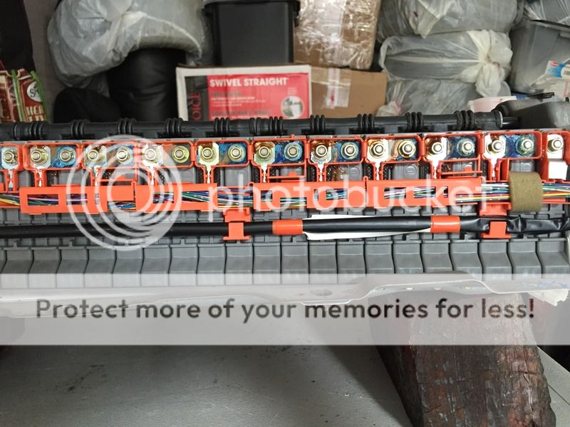

    Oh yes, I have removed the buses and realized the copper connectors actually pop out. Nice.
    I want to kill the idiot that put sealant on the buses. :-/
    Put a brass wire wheel to them:
    I turned the buses upside down and used the DeOxit D5, making sure it does not creep down where I do not want it :)

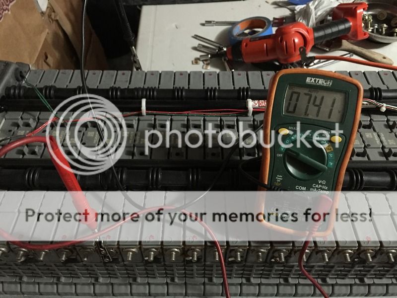

    10 hour later, first time tearing down a HV battery in a Prius, Wow I am very satisfied with the results so far. It only took 1.5 hours to remove 2 hours to install. Bulk of the time was cleaning those copper connectors and battery contacts. I'm beat.
    Seriously with all the corrosion, I could not see how it was even charging.
    Completed the Battery Service and verified it was block 16 (module 31) read 7.41 Volts.:-(
    Most were at 7.8-7.9 volts. Two at 8.2-8.4 volts (block 19), two were 7.6 and 7.7 volts
    Will wait to see how the cleaning holds up, if another CEL then I will order 3 new old G1 modules.
    I should have tried to trickle charge that low one :-/

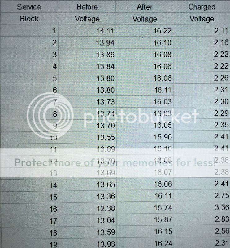

    She popped the CEL again. Wow, the frequency is getting shorter and shorter. That darn module 31 is just too low causing the MIN to be too low for the ECU's liking.

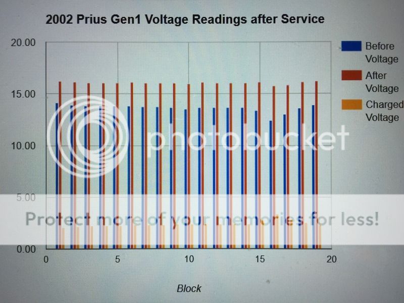

    I just realized you posted a load test chart up the page...
    You need to address blocks 15, 16 and 17. You should probably address 10 and 18:
    EDIT: corrected voltage for block 8.
    DRACO likes this.

    Oh my goodness, Thank you so much for charting it out!

    I think Steve had a typo on block #8 . Under the 46.82 amp load the voltage was 13.74, not 13.47 volts. The discharge test is just half of what can be done. Do a charge test. The same modules that were low should then be high. Most likely just one of the modules in each block is bad.

    Thanks for catching that. He's correct. Fat-fingered #8. #8 is fine. 16, 17, 15, 10, 18 in that order.

    I took a look at the data. It's a bit messy. I'm not sure why, but your sampling rate is about 8 seconds... The discharge portion shows nothing new. I found 52 seconds of ~12A charging. Unfortunately, it peaks at about 55% SoC, so the block Voltage distribution won't change much. Your version of Techstream is spitting out CSV files in an almost undecipherable way at least in terms of delimiters.
    Very busy chart. I didn't label them all.
    12A isn't much to go on, so nothing can be gleaned from the above, but it's illustrative of what you can chart.
    Steve

    I have the latest TIS 10.XX
    I am going to check with an older version 9.XX
    So, it appears 15,16,17 have the biggest spikes, maybe 18?

    I'm OK with 15, 16, 17, and 18. I suspect 16 has been running hottest so it would have heated 15 and 17 for sure. But 8 has me scratching my head. Why 8?
    FYI, weak is not a failed cell, yet. Loss of 1.2V in a module pair and one has died.
