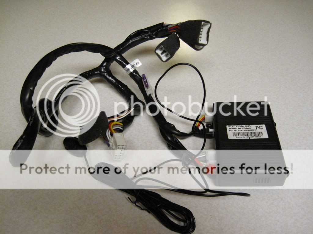

    The above method is basically how I have Blu Logic installed in my Prius. Here's a picture, you can see how the cable configuration acts as a passthrough.
    (not my picture, credit snyper [OP] on Toyota FJ Cruiser Community)

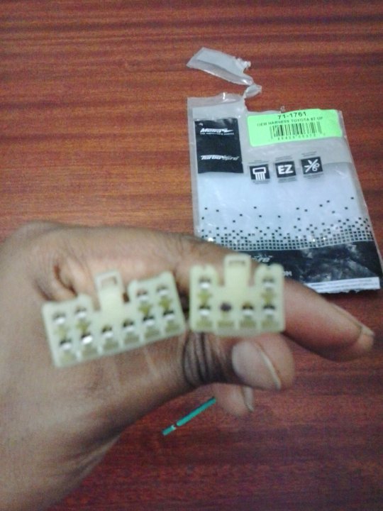

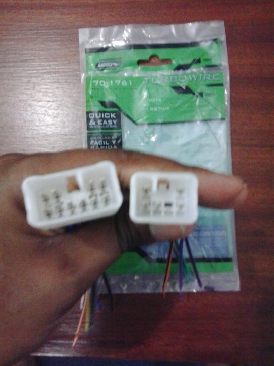

    Okay. I ended up making the Y-harness/pass-through described by Electrontechnik. With everything connected as it should be the new HU I am using still will not work, but the stock radio will. If I disconnect the connectors at the back of the stock radio the new HU will work. I am not sure if this is an issue with not enough power being supplied to have both radios connected, or if there is an errant signal from the stock HU that is causing an issue with the new after market HU. The new unit is a JVC and it simply says "check wiring and reset unit" when the stock stereo is connected. Is there any way to supply it with its own source of 12v power? Does any one have any suggestions?
    For every one's information I used 2- Metra 70-1761's and 2- Metra 71-1761. I used two male sets and one female set to make the pass through and used the other female set to mate to the stereo's connector.

    My Blu-Logic Bluetooth harness basically does the same thing as the radio inline "Y" that I envisioned and MikeBeavers made. The schematic for that cable though, is not easy to come across.

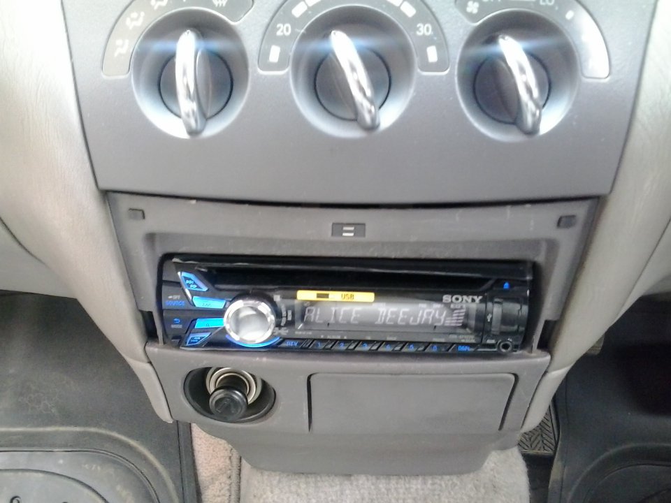

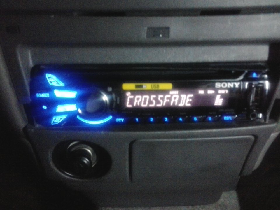

    I finally managed to install an aftermarket stereo (Sony CDX-GT522U) into my 2001 Prius.
    I used two wire harnesses (metra 70-1761 and metra 71-1761) that I procured from sonicelectronix.com.
    Attached are some pics (taken under artificial light) of the wire connections (though roughly done) and the stereo in place.

    some pics in natural light...
