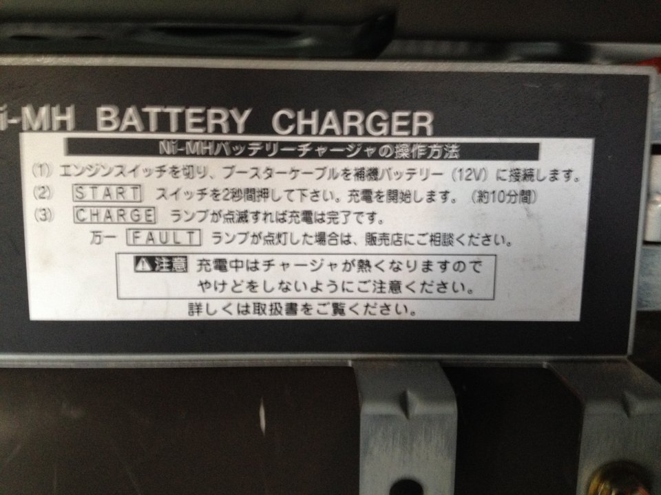

    Built in Charger
  2. hybridbatt

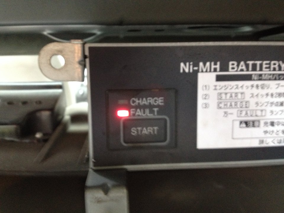

    52
    Northampton UK
    Ah ha thats better!!

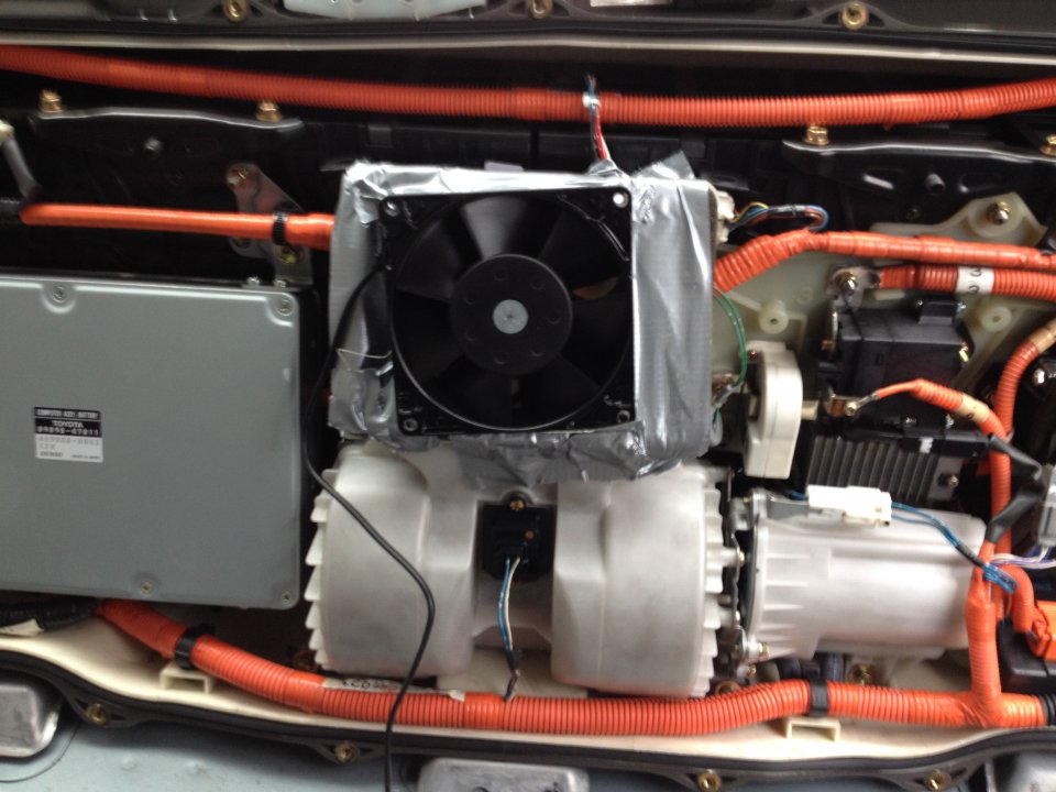

    Cooling fan assembly with my little blower taped on

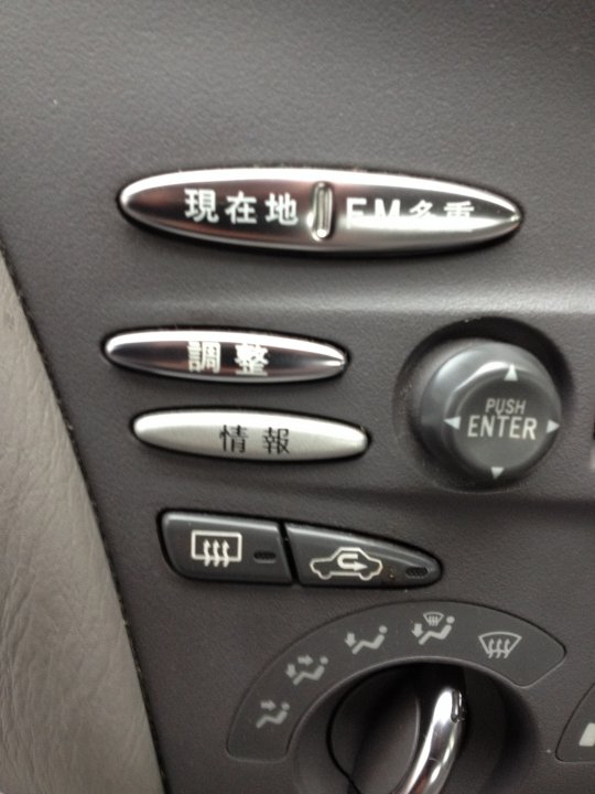

    Some weird buttons in japanese, oh by the way took it for a little run, runs great in reverse on electric but engine starts & runs in D it goes ok then shortly after the little tortoise (pesky thing i will fix him you see if i dont!!!)
