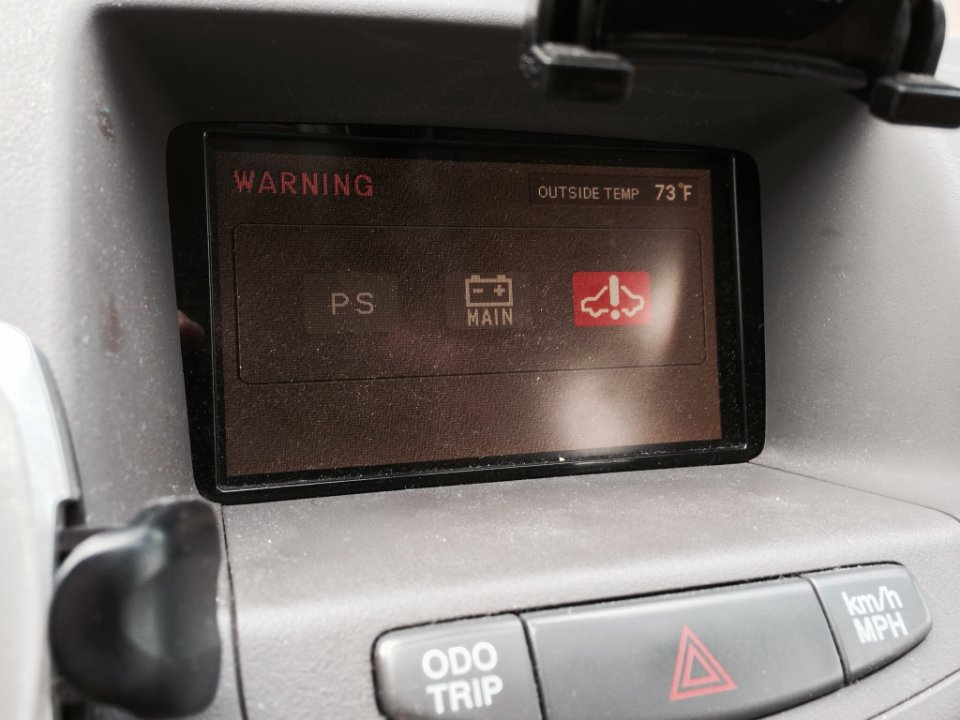

    It's been a year since I've posted anything... Knock in wood and a move to Arkansas has me wondering who to take my daughters car to.
    The red triangle light and the car with the ! Light went off and these are the codes the local shop has found:
    P0121
    P3190
    P3191
    C1259
    C1213
    P3101
    The shop I went to in Little Rock would not touch it.
    Can anyone put these together and help me diagnose where to start?

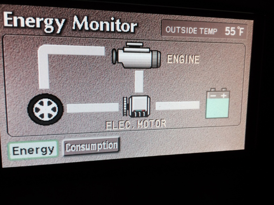

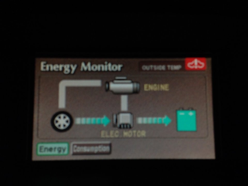

    Thanks Patrick, here's an update. I was unable to get part today (shop didn't deliver on time), but I did drive for 20 miles with some odd things I noticed:
    -I noticed sometimes when driving there was no energy transfer indicator going on on the display for maybe 2-3 seconds
    -I also noticed that I would be going along at 60 mph and the energy indicator would show that I was charging the battery- I didn't think that occurred unless I was braking ... Am I wrong?
    -I think twice in 20 miles the hybrid battery indicator went to 50%
    -all engine light indicators went off earlier today and have never returned.
    I'm going to out that Throttle position sensor on when I get it- but I'm just waiting for the lights to come back on.
    Any thoughts?

    I think this is normal behavior.
    Normal. If the hybrid vehicle ECU thinks that the traction battery needs some charging, it will route power to the traction battery via the inverter even when regen braking is not occurring.
    It is normal for the Classic battery SOC gauge to move between 50% and 75%. When you start to see the gauge move outside that range, it is time to get worried.
    It is good that the warning lights went off. There is no need to disturb the throttle position sensor until the check engine light returns. At that point I suggest that you first confirm the current list of DTC.
