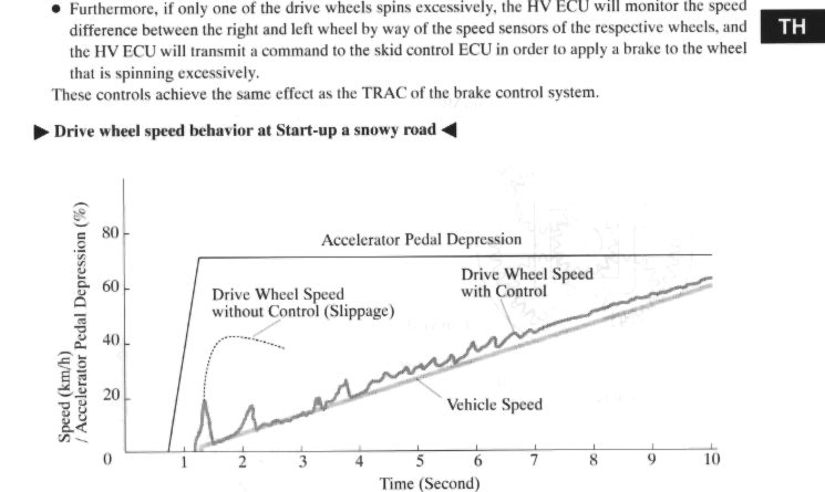

    Traction control does let my tires spin, by a controlled amount. I'm driving a Gen 3, but this graph from Gen 2 shows it was designed that way then, too. It allows the driving wheel speed to stay a small, controlled amount faster than the actual vehicle speed:
    As for tires, I have always found them to start spinning more easily, way earlier than the rated tread life would suggest. I think I saw it explained in Consumer Reports a long time ago as a side-effect of the way the rubber is compounded; the grippiest formulation being in the outermost layer, which wears away down to a somewhat harder material. It's kind of disappointing, but I don't think I've ever owned a set of tires where I didn't notice that.
