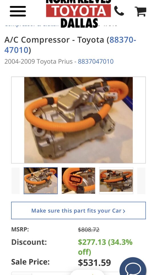

    Without a leak you can't have low refrigerant unless it was low to begin with and never worked right.. With a poorly designed aftermarket compressor you could have low pressures.
    There are other possibilities like a bad txv or a blend door allowing heat during ac. A good ac tech knows how to check for those issues.
    I would get a new compressor from Toyota and split the parts cost if he covered the labor and refrigerant.
    This is an online price which might be further reduced in the cart due to the nationwide July 4th sale.
