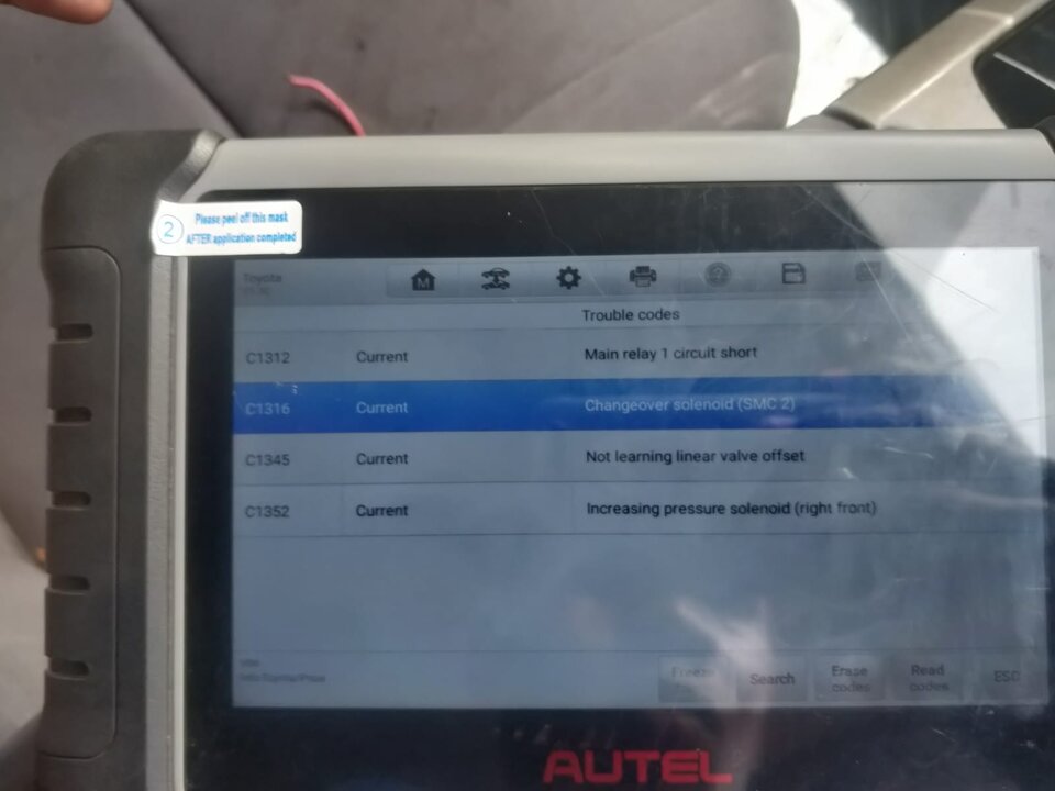

    I have these codes and I need help with it
  20. Hayslayer
    Hayslayer Active Member
    Nov 6, 2024
    539
    331
    Start with inspecting/replacing the ABS relays. You may be able to get used ones for $1 each at a salvage yard. They were used in 100s of different Toyotas, so should be readily available. See if that clears the C1312. Fix the obvious first. That's very obvious. You may get lucky and it solves the other problems, because if that relay is staying on when it shouldn't be on, it may (or may not) be causing those other codes. I haven't dug into it, but, first things first.
