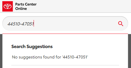

    Unfortunately the only references this part number I can find are on sites like ebay, for used parts. No OEM shops list 44510-47051. Toyota.com doesn't even know this part number.
    Someone posted that they got it from Group 1 but they do not have it either. (and their parts search looks suspiciously like the Toyota dealers.)

    OK and another user in that thread called a dealer and confirmed 44500-47141 was the current part number. Then they said:
    So I ordered a brand new 44500-47141. The receipt shows 44500-47141. The Toyota box has 44500-47141 on the label. The part inside is labelled 44510-47051.
    So, I guess I should order 44500-47141.

    When you order it from the parts department, it'll be under part 44500-47141. The reason is because this part is sold with a resistor. And because of that, Toyota had to create a part number for you to purchase with the resistor.
    So when you order 44500-47141, it'll come with the actuator part 44510-47051 and the resistor
