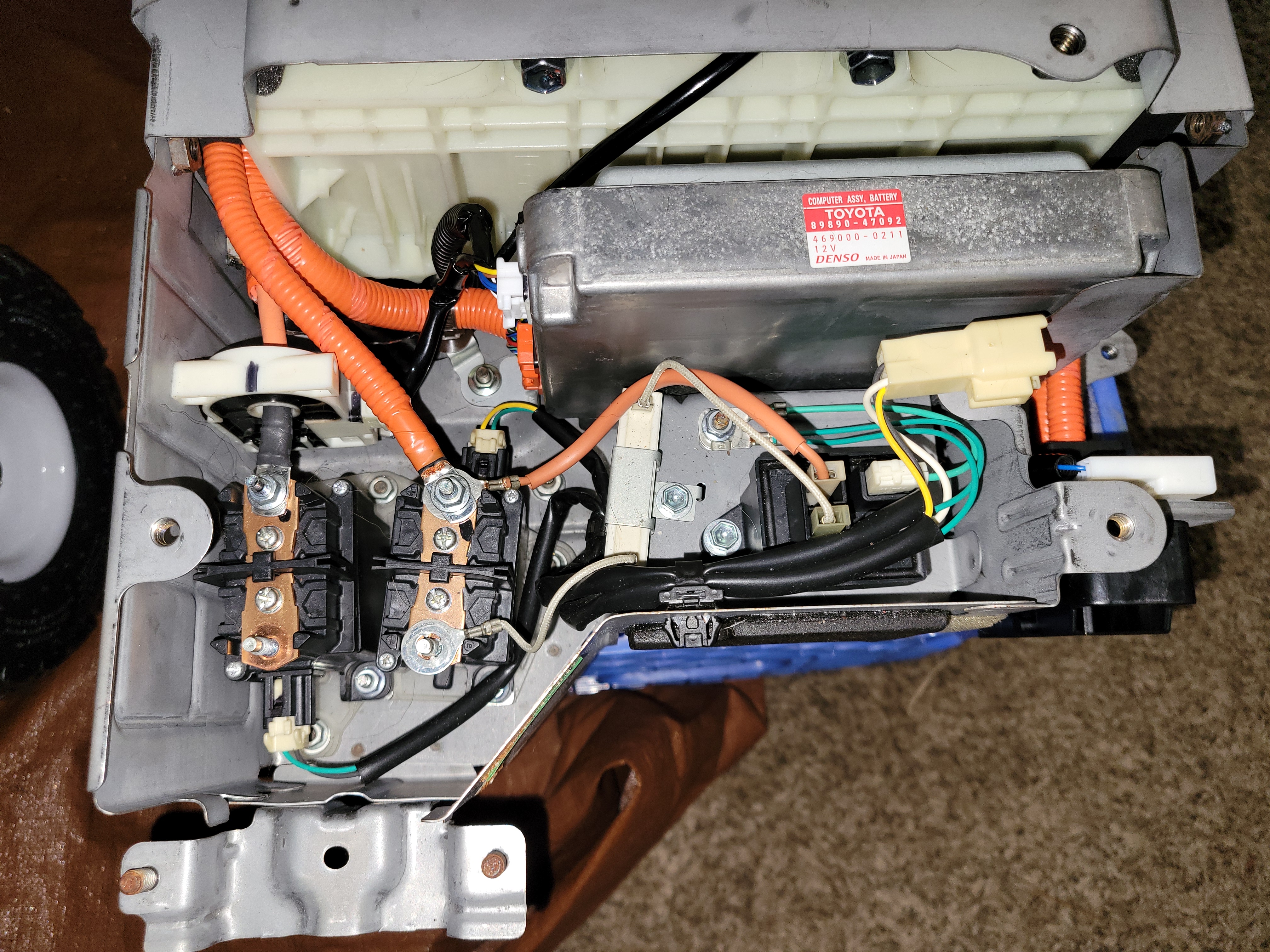

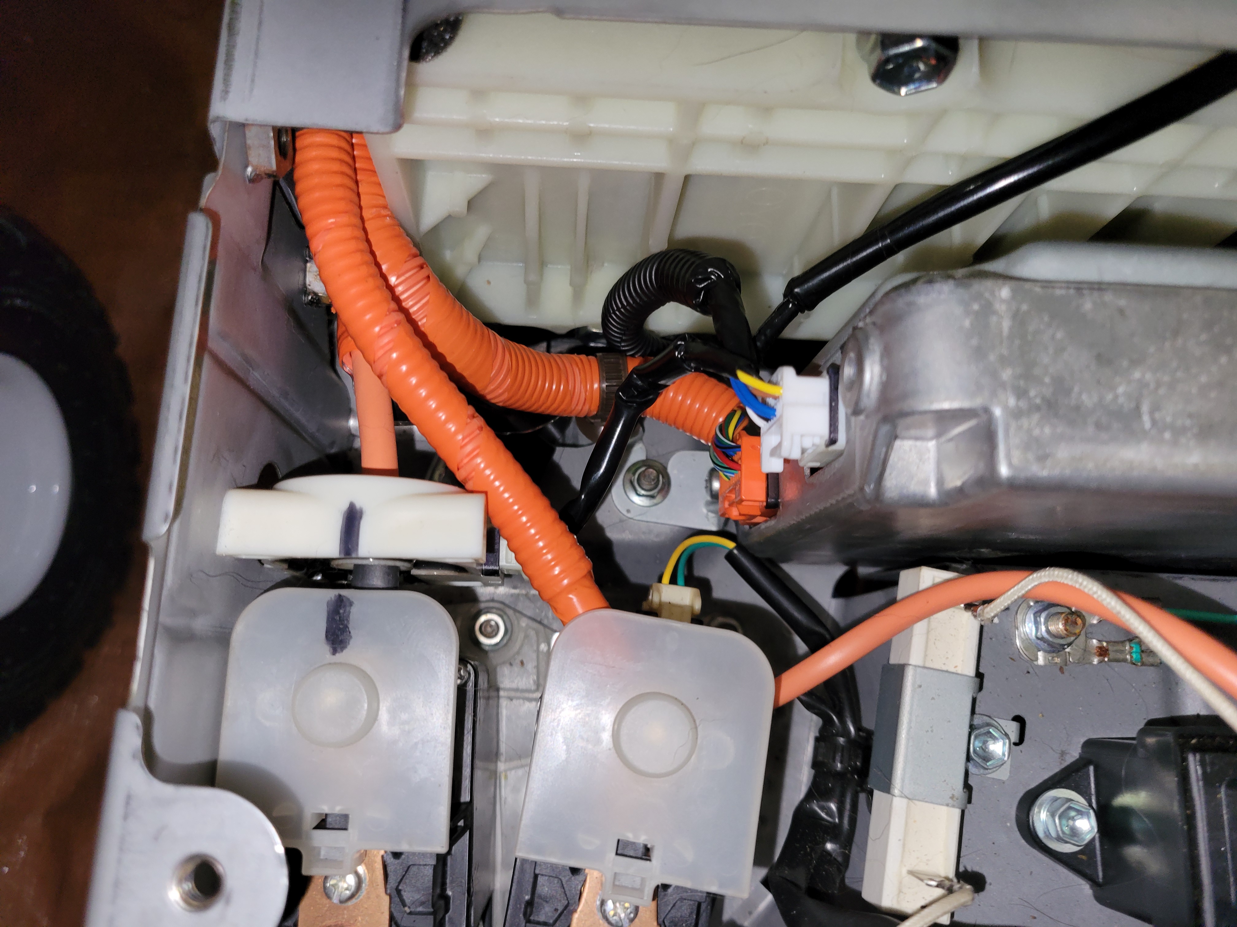

    I got my new battery yesterday and put the components from the old one on the new one
    Something of crosspost
    Everything look okay. I think I did do everything right but sometimes you want an extra set of eyes

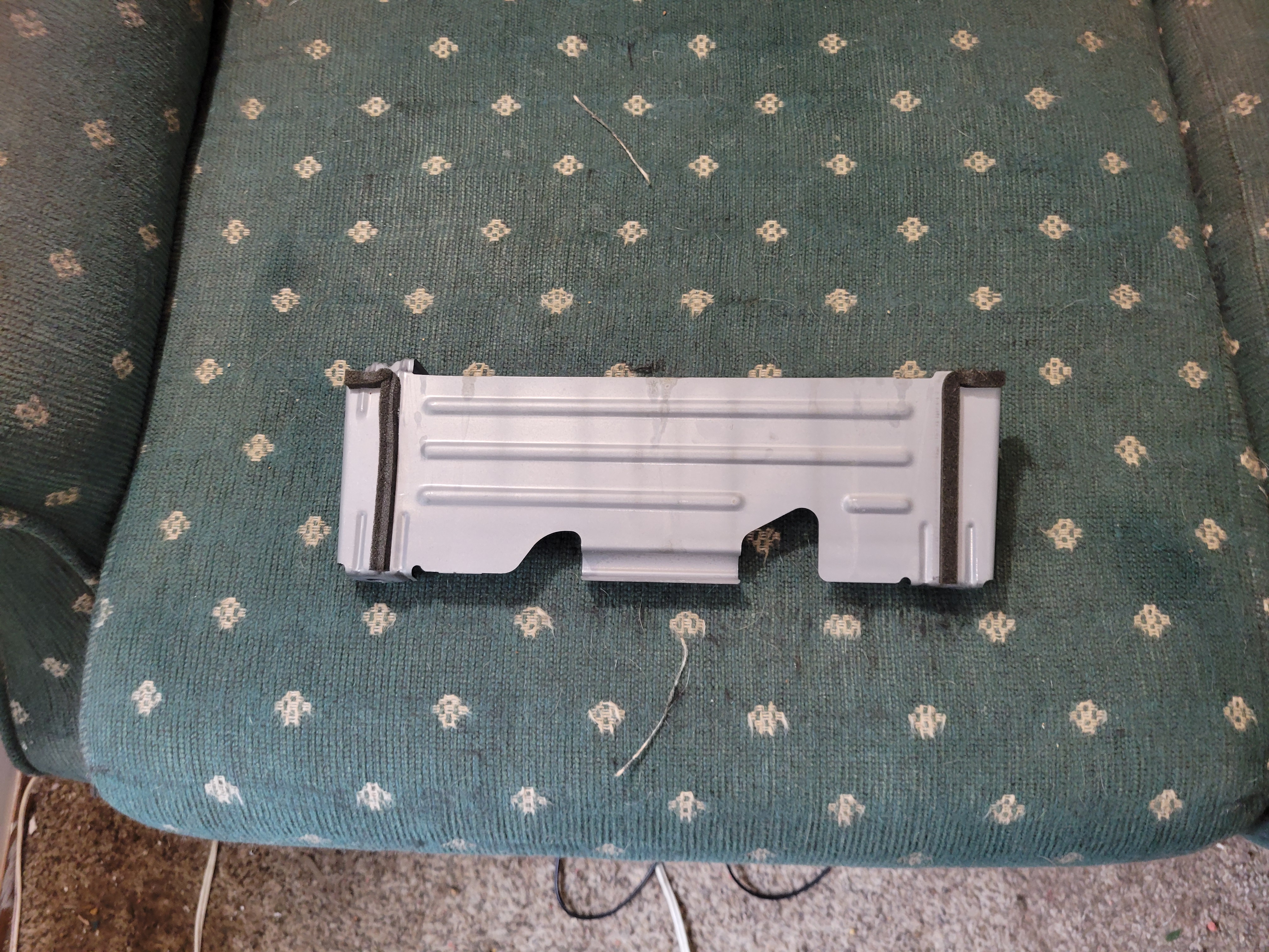

    I cannot find where this part goes if anyone can remember. Removed it when I was originally looking at the battery.
    Edit: Never mind, found it on a picture and know where it does. Goes in the back.

    Looking good. Double check every plug is seated all the way. Recheck the torque of your nuts. Make sure your hybrid battery is super clean along with the ductwork. Then once the battery is in the car before you put the plastic pieces and seats back. Reseat the safety plug, make sure it is latched and test drive. once satisfied then re bolt the seats and rear hatch pieces in.
