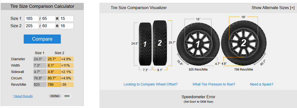

    Also, gen 2 spec tires are significantly smaller outside diameter. Here I've plugged in the smaller tire size for both the gen 2 Prius and Prius v. Worth noting, while both vehicles have optional larger diameter rims, the outside diameters of the tires will not vary significantly. Gen 2 on the left:
    From here:
    Tire Size Comparison
