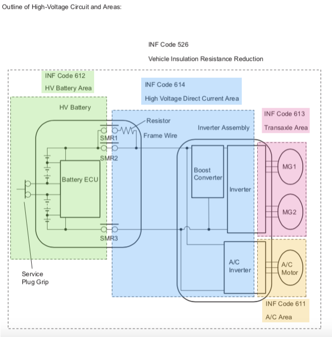

    The P0AA6 has one sub-code – 526 – that means an electrical isolation fault was detected, but I need one more power cycle to determine which HV sub-system has the fault. On the second power cycle, the specific area is indicated by one of four sub-codes (INF codes) – 611, 612, 613, and 614. The specific areas are shown in the diagram below:
    If the Toyota technician pulled the 612 INF code, then yes, it would be your battery. If it were one of the other INF codes, then no, it is not your battery.
    Brian1954 likes this.
