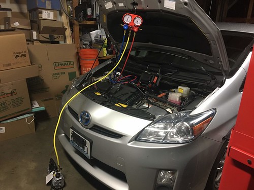

    Finally got around to this job. Just replaced 2 o-rings on my AC system along with full moisture vacuum removal, oil injection and refill. Thought I share play by play of what happened.
    Before I start, there are quite a few steps that unavoidably release a little bit of freon into atmosphere when DIY at home so just be forewarned since we Prius drivers seems a bit more of environmental warrior :) Not sure AC shops do much better. I'll outline where these are in my play by play.
    After filling to factory spec (~1lb or 460g), I was surprised I don't even get to 100 psi on the high side (All the youtube videos I watched shows 200+ psi on high side with mechanical compressors. Prius repair manual also specs 199-228 psi) Not sure if my high side is defective or the AC gauge is defective. Low side is within Prius repair manual spec (21-36 psi) Vent blows cold, low pressure line is cold, sight glass has no bubbles when running and some bubbles after shutting off, AC compressor is quiet (was noisy when system was ~empty).
    Tools + Supplies (all pictured at bottom)

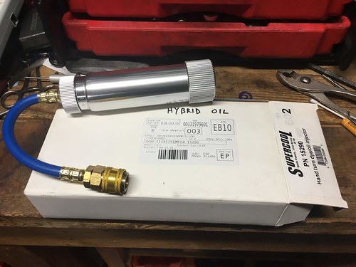

    - Bought an AC oil injector. advancedautoparts.com must have a pricing error. Serious machined piece of equipment with high quality valves for like $5 before 25% off online coupon haha.

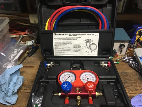

    - O'Reillys tool loaner for 1.8CFM vacuum pump and AC gauge manifold set (~$300 deposit, refunded with 48 hour return). Folks at this particular O'Reillys were really knowledgeable, They knew to order new rental tools for hybrids to avoid mechanical compressor oil contamination. Another nearby O'Reillys was clueless so YMMV.
    - R134A can tap ($7 local O'Reillys auto parts store)

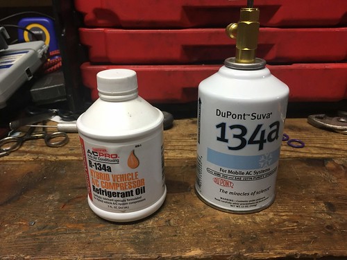

    - 3 x 12oz cans of pure R134A ($6.50/can on amazon)
    - 1 hybrid AC compressor oil (advancedautoparts.com $18.50 before 25% online coupon)
    - 1 halogen detector from ebay ($20)
    - 270 piece HNBR Auto AC o-ring kit ($5+ amazon)
    Oil Injection
    I injected 2oz of hybrid AC oil about a month ago because there was oil residue on the high pressure pipe coming out of the firewall. Wanted to make sure compressor didn't get damaged before repairs. When I called an AC shop to ask how they determine how much oil is in the system, they said they use an injector to inject a couple of oz during recharge. Its an guestimate but better than no oil in the system. Too much oil also makes the system inefficient. Anyhow, their explanation led me to purchase the injector as a necessary tool.

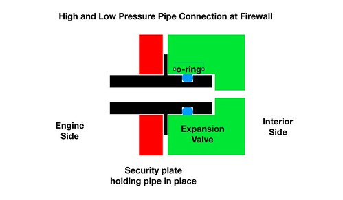

    Change suspect leaky high+low pressure pipe o-ring at firewall
    I had oil residue on the high pressure pipe at the firewall, I reasoned these o-rings were the most likely leak source. Just about all the R134A already leaked out and system had very low pressure so I just released the remaining system pressure (lasted maybe like 5s so not much freon remained)
    Took out the 10mm bolt on where H+L pipe entered the fire wall to release the secure plate. Then just pulled both pipe out. Also removed the 10mm bolt on the low pressure pipe near front of the engine so I can pull the entire L pipe out to change the o-ring. Impossible to do it way back in the firewall with little access and deep recess for o-ring seat. Was able to do the small H pipe's smaller o-ring hear the firewall but took a while with one less dextrous left hand/fingers.

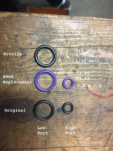

    O-rings
    As mentioned, the 2 original o-rings looked fine. Was pliable. I decided to put in new o-rings from an auto AC HNBR kit and sized o-ring walls slightly thicker to give it slightly more compression. It was slightly harder to put pipe back in but not too bad so probably ok. See diagram below on how these o-rings are compressed.
    The low pressure pipe's connection in front of the engine had exact same o-ring as back in the fire wall. But I was not able to slip on a slightly thicker o-ring here. Clearly, the machined fittings are slightly different here than back in the firewall. Either by design or manufacturing defect. But clearly, some reasonable margins on o-ring thickness and amount of compression is okay. Given how easy the firewall side slipped in and out, I thought thicker o-ring would likely compress better.
    Vacuum

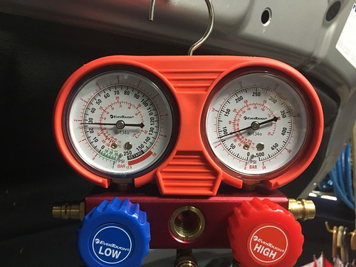

    Hooked up the AC gauge+manifold with vacuum pump (if brand new, need to fill with compressor oil) to vacuum the moisture out of the system. I first vacuumed just like 1/2 min and stopped. But the vacuum was eventually lost as moisture in the air evaporated and increased the pressure. This is why you have to vacuum for 1/2 to1 hour to remove all the moisture. Did that and vacuum held for entire night (was missing a R134A can tap so couldn’t fill until AM) Most people suggest vacuum 30min and confirm vacuum is held for 30min.
    No significant amount of AC compressor oil came out during my vacuum process. The vacuum vent port felt a little oily but no droplets. Perhaps 1.8 CFM not enough to pull the oil out.
    These AC gauge set are all made in China with error in directions. Told me to hook the H lines to low gauge vise versa so be careful if you encountered that.
    Guy on youtube said avoid opening the AC line ports on the car all the way as they can damage the valve. I had no problem on this car. Just beware.
    When done vacuuming, make sure AC gauge H+L valve is closed before recharging as supply line will be bled.
    Recharge 1st can
    Tapped a 12 ounce can and weight it with the tapping valve. Connected to the AC gauge supply line and open the can valve. Then open the supply line at the AC gauge manifold slightly to bleed out any air in the line so it doesn’t go into your system (a little freon will be release at this step and is allowable according the youtube folks) Opened both high and low valve until pressure gauge needles stopped moving. This basically allow can’s pressure to equalize with car’s AC system. Close the high side valve on the gauge (only want to refill via low port when compressor is running). Start the car and crank AC up to high (temp = LO, fan=max, AC light on). Car’s AC compressor when running suppose to draw in the freon from the L port.
    High side pressure started out around 50psi and took forever to suck in the freon. I eventually lost patience and pickup the can and turn it upside down periodically (I read afterwards I'm not suppose to do this as it may put liquid into the compressor input and damage it. Hope thats not the case. ). This allows more liquid freon to enter and is visible in the AC gauge sight glass. Took awhile but eventually the can was empty (shook it and heard nothing inside and gauge pressures seemed fixed) High side is still between 50-75psi at this point.
    Close the H+L AC gauge valves (supply line will be opened to move to 2nd can). Close the can tap valve and disconnect the supply line from the can. Some compressed freon in the line will leak out. When removing the tap from the can, what little freon remain in the can will leak out.

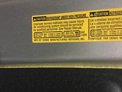

    At this point, about 12oz (340 grams) are in the system. Engine bay sticker calls for about 460 grams so another 4oz or 115grams from the 2nd bottle.
    Recharge 2nd can
    Connect the 2nd can and connect to supply line. Open the tap valve and release the supply line at the manifold slightly to bleed out the air again (a little freon leaked out here). Then place the can on a sensitive scale (used my shipping scale that measures oz and grams) Unfortunately the scale won’t be precise as the supply line is attached so just an approximation.
    Started the car and put AC on high again and then open the low side valve on the gauge. Turn the can upside down a couple of times until I thought about 100+ grams went in. At this point, high side PSI was 75 and car’s high side AC sight glass showed no bubbles. Closed off the H+L valves on the manifold. Shut off the car/AC. Closed the can tap, and closed the AC gauge valves on car’s AC ports and removed them. Put the car’s AC port’s caps back on and all done.
    I think I did everything correctly except for some liquid charging rather than vapor. Anyhow, vent blows cold but we’ll know better by summer time.

  11. ChapmanF
    28,758
    19,080
    For others reading, that part is worth repeating in bold face. Close the high side valve on the gauge (only want to refill via low port when compressor is running). Then make sure you did it.
    There's a reason ... if that valve is open and the compressor starts, high side pressure will flow back to your refrigerant can, which will blow up, possibly taking bits of you with it.
    Chances are you lucked out, or you would know by now, but yes, that's luck. Don't do that. When an incompressible fluid gets sucked into a running compressor, something will happen ... and it won't be the fluid compressing.

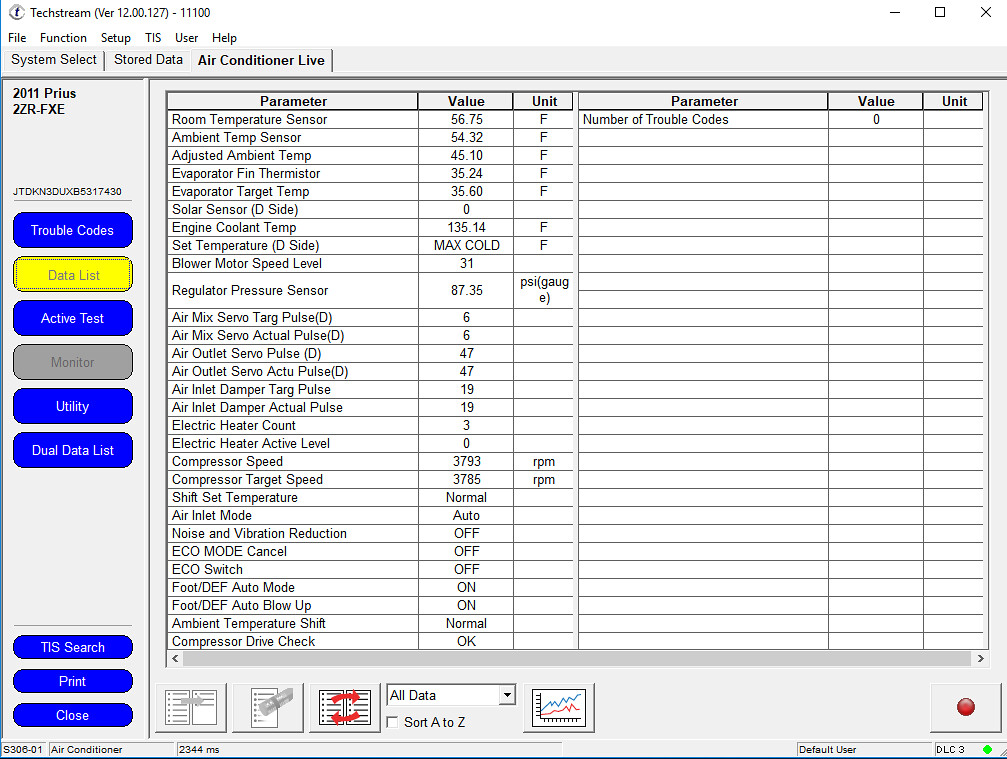

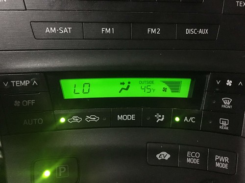

    More update for everyone. Here is the Techstream info on AC system and HVAC settings after running it for a few min.
    Some interesting readings to note
    - Evaporator Fin Thermister temperature reached the target
    - Compressor near 4k RPM
    - Regulator Pressure Sensor reads 87 psi (I've seen this just above 90). I believe this is the high side reading.
    Vent does blow cold, Low pressure pipe is cold with condensation on it. But AC doesn't have to work too hard in the dead of winter here in the northwest winter.
    I put in about 1 lb R134A (spec) but lost some that got trapped in the AC manifold gauge's high side line.
    Most PSI charts for R134A on high and low side does show probably closer to 100psi at 45F ambient temp. So perhaps 90psi shows I'm just a little bit low on freon. R-134a System Pressure Chart - AC Pro<?php/* bloginfo('name'); */?>
    What does everyone else get on techstream at max cooling? In particular, regulator pressure sensor.

    Yes your readings on the high side sensor are correct for a cold ambient temperature you can have well below 100 psi on the high side while you’re driving down the road on a cold morning.
    I believe they released a video on Prius chat also on my YouTube channel of me driving my Prius with remote Bluetooth temperature sensors in pressure gauge is showing extremely low pressures on the high side while you’re in real world driving down the street. That is normal.
    Real world driving with 25 35 mph air blowing against the condenser is vastly different than a car sitting in your garage with the hood up sitting still.
    Under low load conditions like the dead of winter you can nearly be half empty on refrigerant and still get condensate on your suction line and cold temperatures out your dash.
