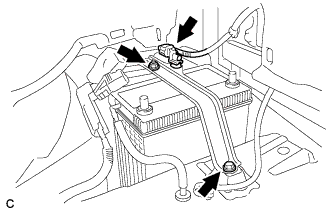

    And regarding lack of hv battery charge/discharge arrows, check your 12v compartment and be sure the ambient temp sensor is connected to it's wiring harness. It's the black, plastic sensor mounted onto the metal bracket which holds the 12v battery in place. Although a shot in the dark, there are threads here claiming this sensor unplugged kills the arrow display of the hv battery:confused:...

    That was the problem for that, after searching the forum I found that to be most issues, its fixed
