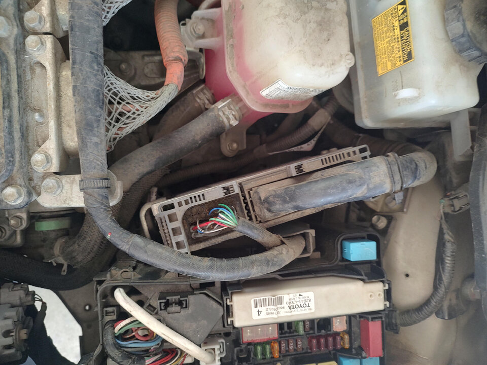

    I'm struggling to remove this module. Back bracket is trivial. I can't even see the bolt for the front bracket. Inverter coolant hoses and at least three harnesses are in the way, but I've nudged them enough to be able to see it. Nothing.
    I've tried loosening the two screws from the bracket to the module, but they stuck tight. I may have to grind off the heads and extract the remnants. Philips screws, hard to get leverage and to keep pressure on the driver. Even tried a Visegrips on the screwdriver shaft.
    Advice or even a pic of the bracket after extraction of the ECM would be helpful.

    I no longer have the Gen 3s but that thing comes right up out of they're . Need to take off the plug on top to

    I already have that.

    Got it! Took two ppl, holding stuff out of way, and better light. I used Visegrips to break the screw heads free.

    It ohm'd out at 3.6ohms. A spec from a different gen (2 I think) has max at 3.0, min much lower. I haven't found the repair docs for gen 3 yet, just the elec diagrams.
    Do you think that could cause the P2102 "Circuit Low" code? Is it that sensitive? I suspect it uses PWM, so maybe?
