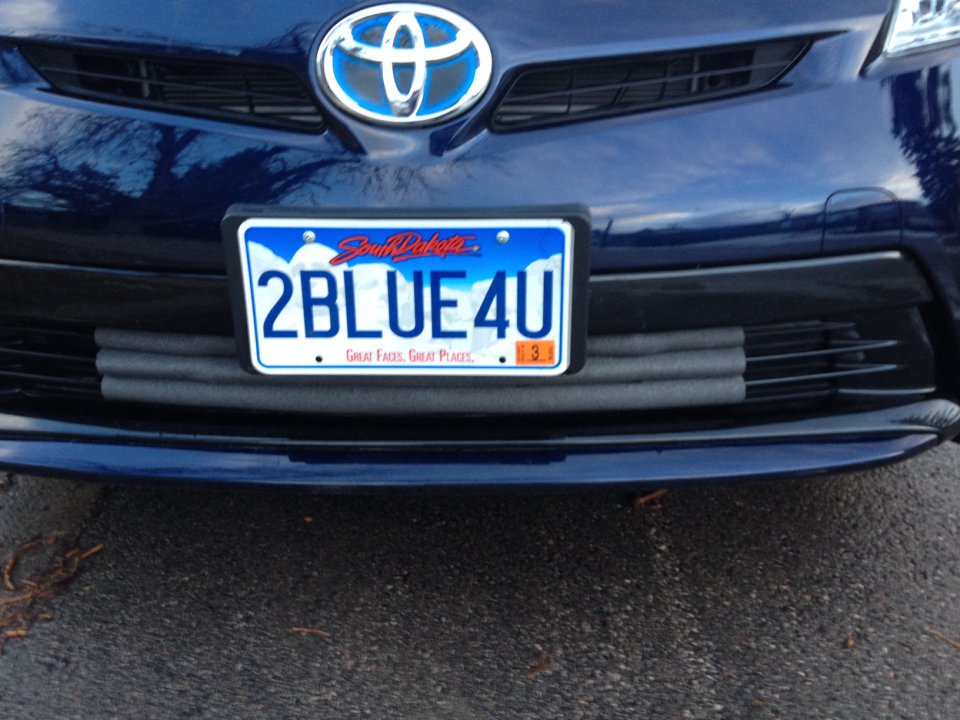

    The following is a short lesson on how to do the Gen 3 lower grill block. 1st step: Purchase 7-8 foot piece of 3/4 inch pipe foam with built in split. I purchased mine at Ace Hardware for $1.49 plus tax. You will need to make 4 pieces. The lower 2 pieces are approximately 2 1/2 feet long. The upper 2 pieces are each about 1 foot long. Step 2: Measure the lower 2 pieces for overall length needed and cut. Step 3: Insert 5 notches to line up with the verticals in the prius grill. Make notch about 3/4 of the way through the tubing. THE LOWER 2 PIECES ARE IDENTICAL. Step 4: Insert lower 2 tubes around the horizontal lattice of the grill. Do not insert BETWEEN the lattices. Notches should line up. When 1st tube is inserted, it will appear loose, but when 2nd one is inserted the fit will tighten snuggly. Step 5: For top 2 pieces, cut each tube 1/2-1 inch longer than necessary so part of it can tuck behind license frame. Only one notch is necessary. Step 6: Fit 2 upper tubes into place.
    If you follow these steps, you will get a very professional looking result. See my picture below.

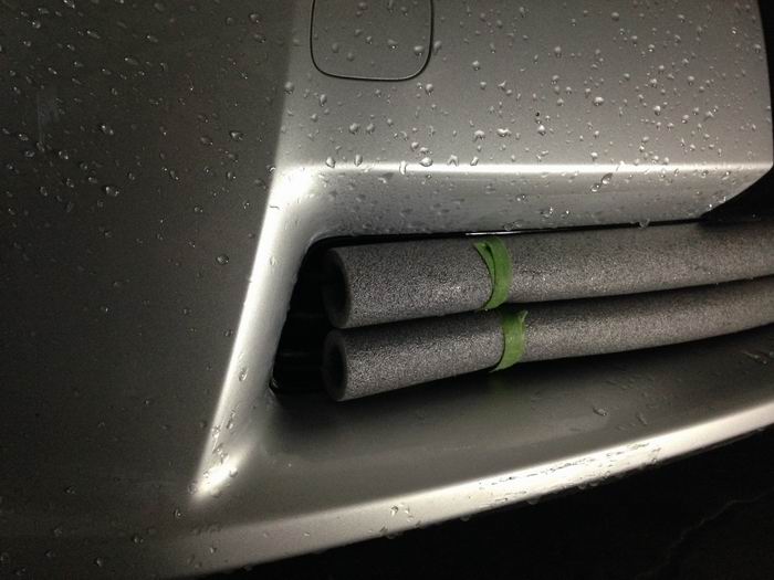

    Why didn't you slip the foam between the grille slats? Between the slats is much less visible like below
    Our Prius would have the foam just as invisible, except I used up old insulation on the Prius which is light gray so it really shows up. I plan to soon redo it with the dark gray insulation that is almost invisible from a distance.

    When you cut notches for the vertical pieces you can stick the foam between the slats and it's very solid.
    I posted pics above of how the dark gray foam blends in on our Fusion Hybrid and on my parents' C-Max Energi. I would worry with having the foam out like you did it that the force of the air at freeway speed would pull them off. When you cut slits for the vertical pieces and stick the foam between the slats, it is very solid and doesn't move. I've washed our cars with the foam in there, driven on the freeway at 70+ MPH and more without a single piece of foam coming lose in the past almost 3 months that I've had the grille blocked.

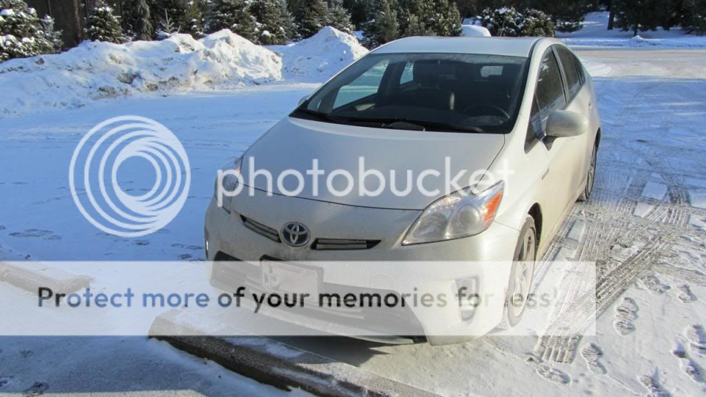

    Here is the hideous job I did back in October. It was my first attempt at blocking so I kinda did a hack job because I didn't really know what I was doing. The pics above of how I did our Fusion and my parents' C-Max are much better quality jobs. I will redo the Prius soon so it doesn't look so awful...

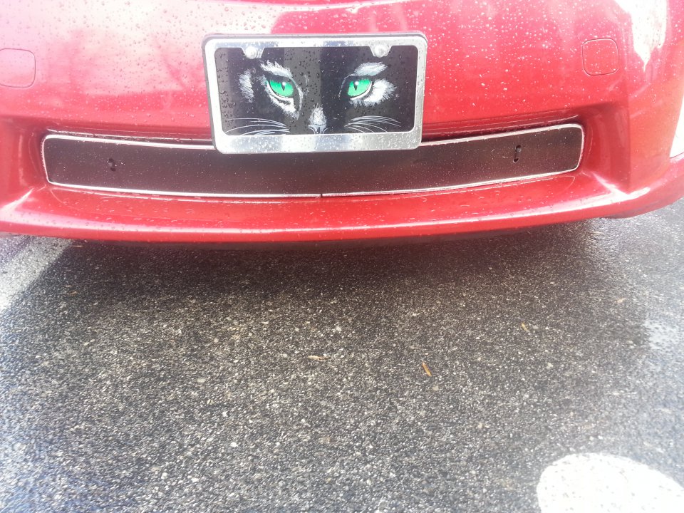

    I posted this in another thread, cut from sheet metal with door edge trim around the edge and held with two black wire ties. GrillBlock[1].jpeg
    James Analytic likes this.
  19. gliderman
    gliderman Active Member
    Aug 2, 2011
    751
    225
    What does you upper intake look like?
    Very nice!
  20. milkman44
    milkman44 Active Member
    Oct 16, 2011
    591
    386
    Ky
    I left the upper part open, last winter I used the pipe insulation on the lower and it worked, but it was more noticeable.
