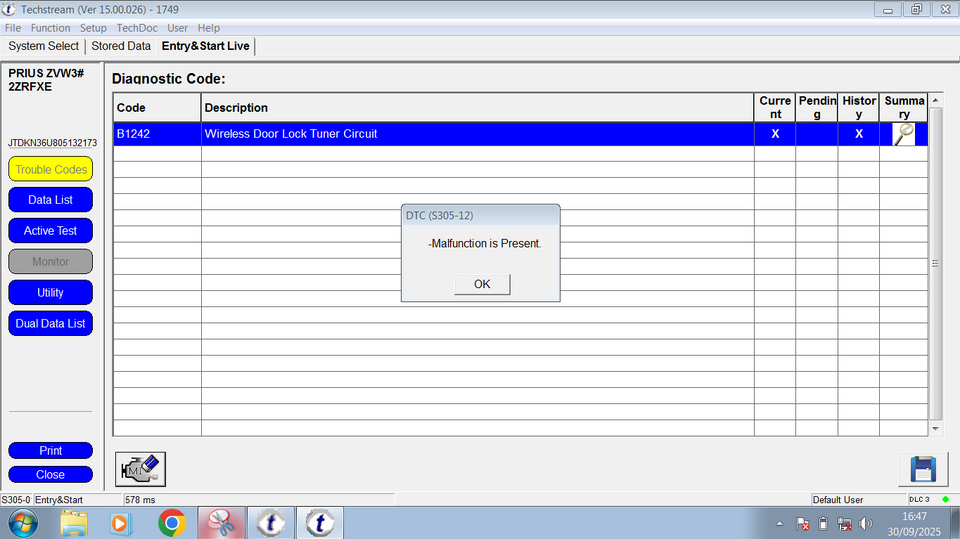

    I am trying to troubleshoot the code DTC (B1242 Wireless Doorlock Tuner circuit) on my 2010 Prius I have no SKS function at all and need to hold the Key fob to the start button to start the car, I did have someone run into the drivers door before all of this started but it was working up until I had a flat 12v battery and then I noticed the key fob was not being detected, even had a car locksmith come to make a new key fob but that did not work either, he said his scanner was detecting a fault on the SKS system?

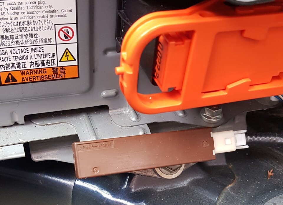

    I scanned it myself using a Techstream interface I bought off Amazon and got the code B1242 Wireless Doorlock Tuner circuit, I have had the drivers door panel off and had a look at the SKS sensor and it all looks fine, does anyone know where all of the sensors/antennas are located there is somthing located near the high voltage battery that looks like an Antenna but I cannot be certain are there any behind interior panels or body panels that you know of?

    The door dent was only minor more of a scrape then an actual impact but the insurance company replaced the door from what I could see after I took the inner door panel off, it came back to me with a fully working SKS system no problems at all otherwise I would have got them to sort it out, the problem really seemed to arrive after I had a 12v battery go flat on me, I have replaced the 12v for a brand new one also the Fob Battery is also new, I noticed every now and then the function of the SKS would randomly return but only for a short time?, when I clear the B1242 Code from Techsteam it reappears after a few seconds?

    .no Gen 3 here anymore I'd think should be something mud car like console area and rear of car gen2 hast it right next to hybrid battery white with dark red writing on .I do not have a gen3 book set

    Thanks again for the assistance, I will see if I can find the one inside around the centre console area it does not say exactly were these things are, I found somthing near the High Voltage battery but the diagram you linked shows one behind rear bumper, I will try all the easy location first, hopefully I will get a result?
