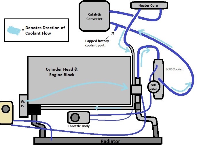

    I diagrammed out how my coolant system is plumbed. Rember, I have a JDM motor with unusual plumbing AND I used the 4th gen’s cooler.
    Most of you will not be doing your swap like this, or using an engine with the lines and fittings mine has.

    I notice you've got the EHRS exchanger (this is really its own separate lump in the exhaust, downstream of both catalytic converters) coming after the EGR cooler and before the cabin heater in the coolant flow.
    Toyota arranges for parallel paths, one with just the EGR cooler, valve, and throttle body, and one with the cabin heater and EHRS exchanger. They put the cabin heater first, so the coolant reaching the EHRS exchanger will be cooler, meaning it can pick up more heat, for a faster warmup overall. Maybe worth thinking about.

    @ChapmanF if needed it will be quite easy to swap the cat for the heater core in the coolant circuit. I routed them the way I did because I was prioritizing the engine’s cooling over passenger comfort.
