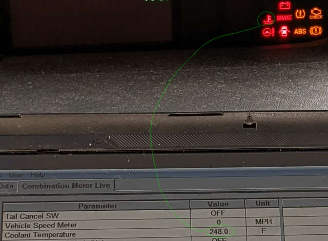

    What would satisfy you as being "a defined overheating temp"?
    There's a red light on the dash that will light up at 248 ℉.
    Now maybe you're asking more "what temperature lower than 248 ℉ ought to be my happy limit?" and for that, of course, you might see varying numbers being advocated.
