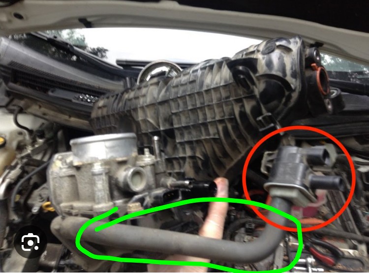

    You were pretty close with vacuum hose. Hose off the bottom of the purge valve though I'm surprised that's enough to prevent starting.
    To be fair, I do not fully understand that system at this time.

  13. Mendel Leisk
    61,477
    42,301
    By that do you mean hose between PCV valve and intake manifold?
    I've missed that, will shut the engine right down, since it introduces a massive vacuum leak. Very easy to miss during reassemble: the intake manifold goes on, and the loose PCV hose is hiding underneath.

    Working Great!
    Circled in green (not my photo)

    It returns gasoline vapours to engine, and yeah, if disconnected a massive vacuum leak.
