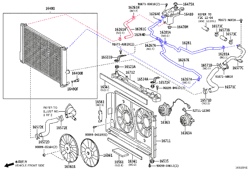

    With the degas design, Toyota has added some hoses to do a lot of that for you. They're the blue ones here:
    As you can see, they come from strategically-chosen high spots at the engine outlet and radiator, and run back to the top of the degas bottle, which is how whatever gas bubbles are in the system end up back there, and that's happening every second the cooling system operates. So that's why the whole gist of the burping process is just to start by filling a bit extra high, then warm up the engine and run it a few minutes past warmup and let it do what it does, and hey presto, the air's in the headspace of the bottle where it belongs.
    There's one more little high spot in the system that hasn't got a blue hose from it, and it's that bend where you've got the white valve there. So by fussing with that valve you can get a bit of air out there.
    But it's worth remembering that Toyota didn't even need a year to realize they could leave out that valve and have their degas system still do what it does. It's a high spot, but it's also in a narrowish hose. If you think about air in different-shaped passages, if it's in a broad one it can just kind of stay put at the top while liquid circulates beneath it (just like it does in the headspace of the bottle), but if it's in a narrow tube the liquid flow carries it along, which is how even that bit of air can still find its way to a blue hose eventually and back to the bottle.

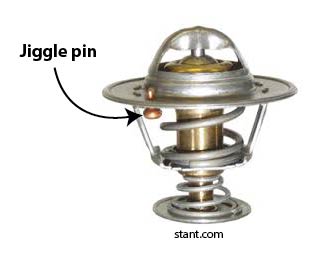

    Just bought a thermostat housing. Your patience on the stupidity of this question is appreciated. Is the brass part in this thermostat the jiggle pin?
  18. ChapmanF
    28,613
    18,947
    No. It may be hard to see (or even reach) because of the way the thermostat is built into the elbow. There is normally a small hole in the rim / crown of the thermostat, with a little, bitty, jiggly, pin in it.
    Its whole purpose is just to give air somewhere to go while you fill. It's definitely not there to solve overheating problems while the engine is running, but a practice of cutting it seems to have sprung up among people doing these swaps. It really sounds to me like the kind of thing a person does instead of finding a problem ... but then I've not done one of these swaps myself, and I've never seen an actual detailed diagram of the plumbing and hose routing that somebody used when they did.
