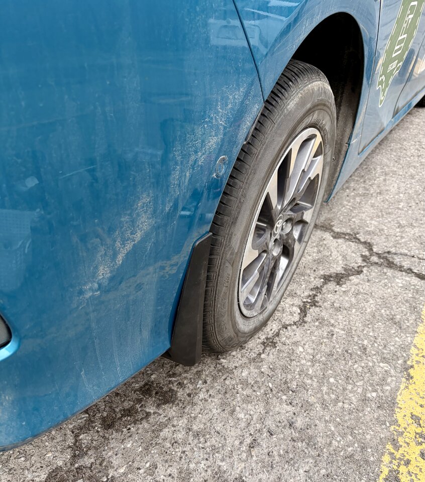

    Hey everyone,
    I spent way too much time hunting for mudflaps for my wife’s 2022 Prius Prime. OEM ones are long gone, and it looks like Toyota isn’t planning to offer them in 2025–2026 either. The only options I could find were a set of rear mudflaps on eBay UK for an absolutely ridiculous price.
    Then I walk across a post on an Eastern European forum saying the European Corolla E210 mudflaps are a direct match (or very close). Took a chance and ordered a full front + rear set on AliExpress for just $25 CAD / $17 USD.

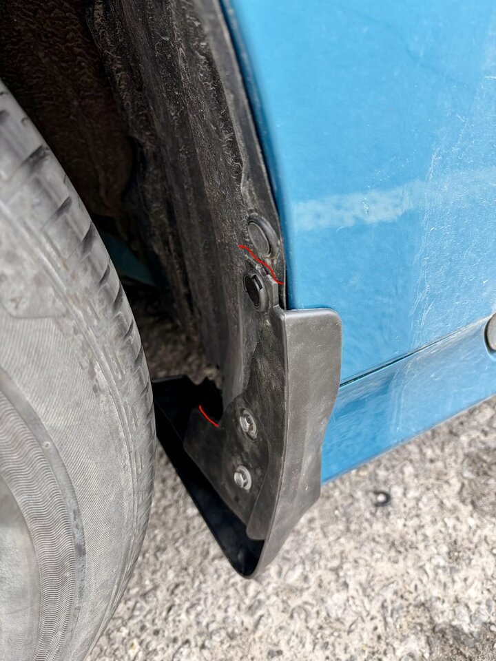

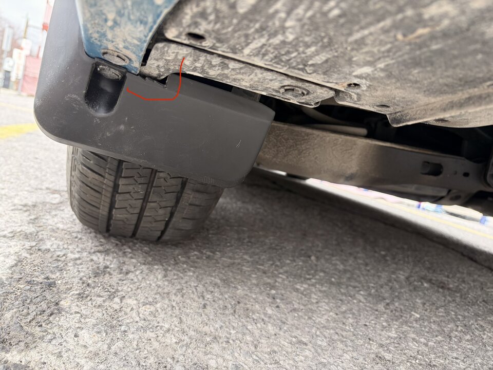

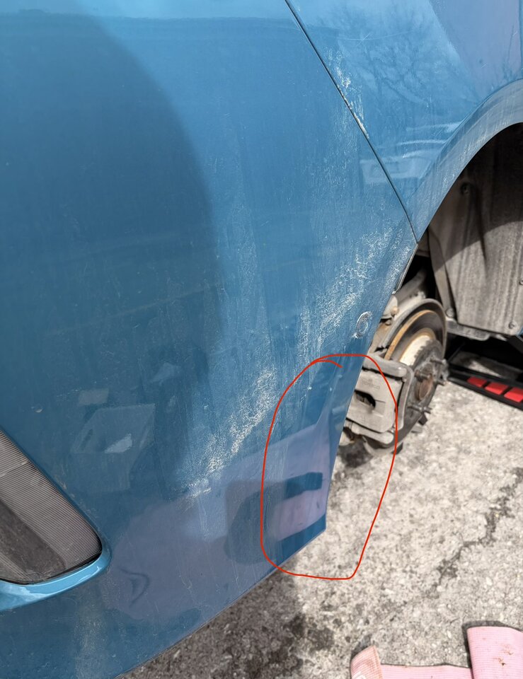

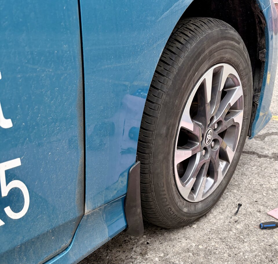

    I’m honestly shocked at the quality — way better than I expected for that price. The material feels good, the fit is totally okay and they look factory-like once installed. I put them on during our seasonal wheel swap. Everything lined up almost perfectly with just a couple of small, easy modifications (nothing major).
    Sorry as I'm new here I can't post any link, just do your research on AliExpress
    If you’ve been looking for affordable mudflaps for a 2017-2022 Prius Prime, these are worth checking out.
    Anyone else running these or similar Corolla-sourced flaps? Would love to hear your experience!
