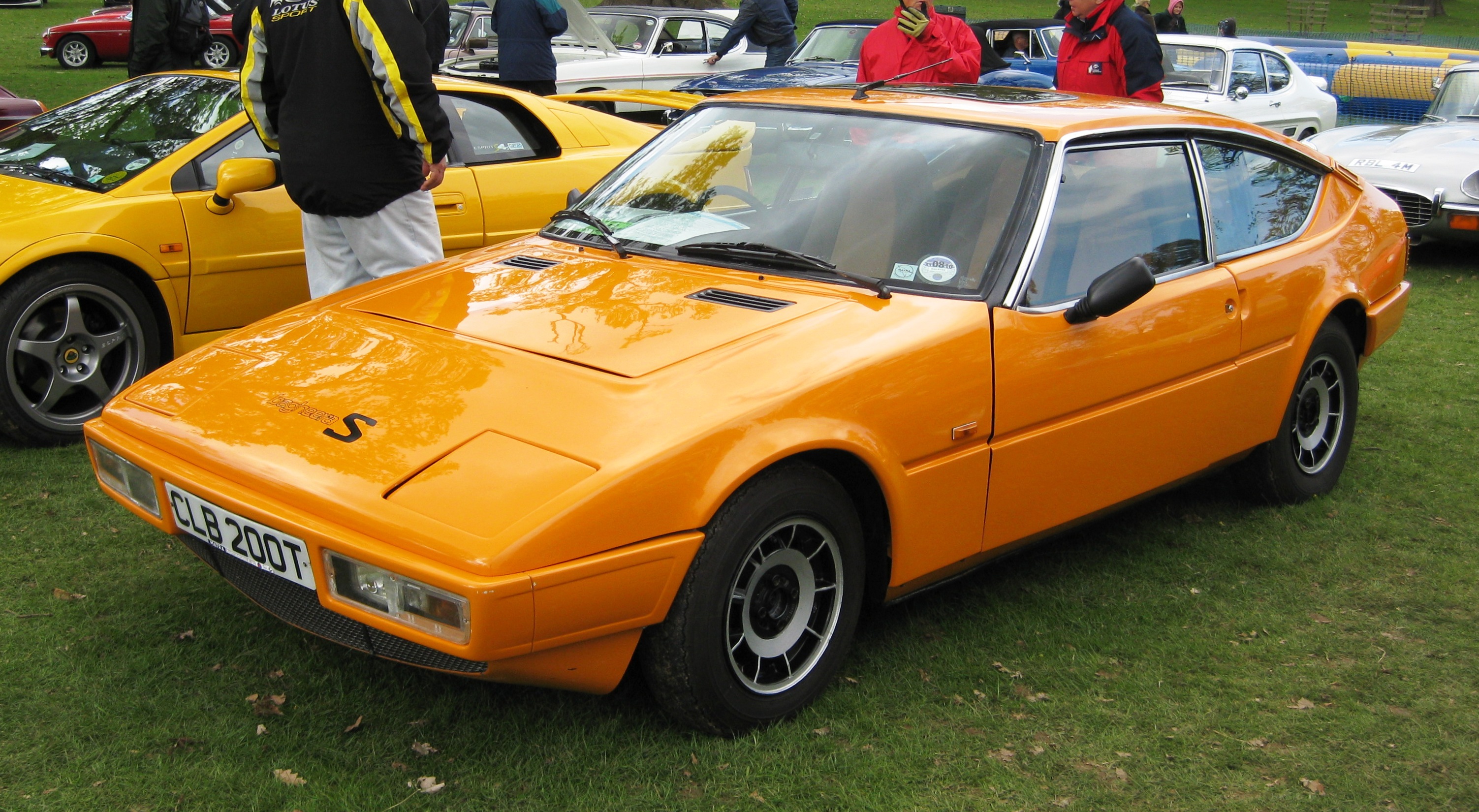

    Some three seaters are quite alright...
    (Female press photographer friend of my mum had one like this).
